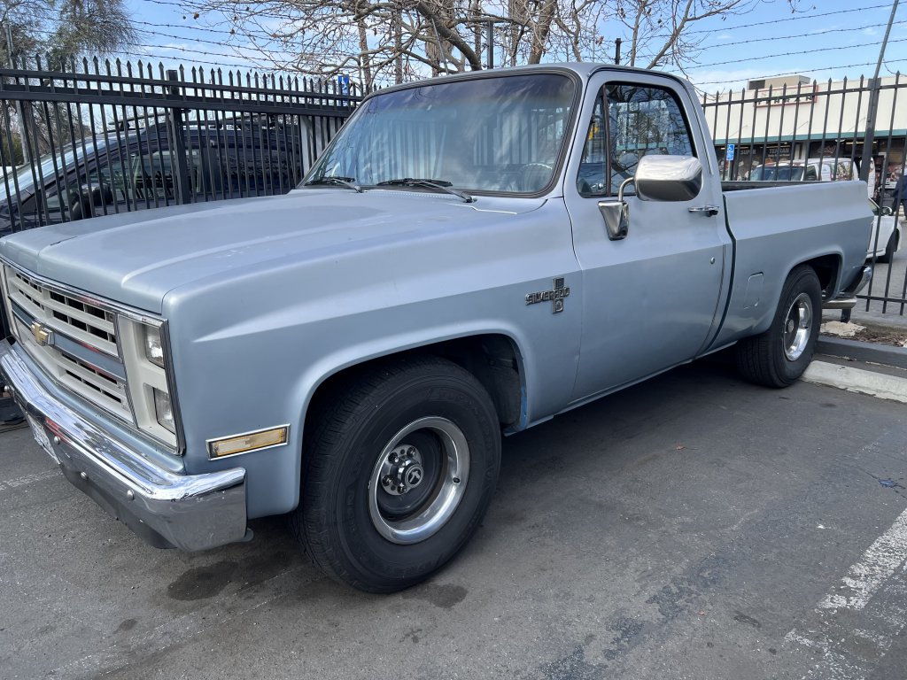

I was wrong on the spring size (they were 2" but needed 1.5") so I fixed it in my original post. These were the parts I ordered-
1 x​
McGaughys 2.5" Drop Spindles 73-87 Chevy GMC TruckSUV 33154 (MC33154)
1 x​
McGaughys 2" Front Lowering Coils 73-87 Chevy GMC C-10 33128 (MC33128)

Tetanus has 2" spindles and 3" springs up front, and a flip in the rear. Gonna raise the front an inch because it hits the inners as you turn....
Man, that’s so low, it looks bagged. I ordered 2.5” springs and 2.5” spindles. I might have to rethink that. This is the look I’m going for.

It's too low for stock inners, but not bagged low. I'll raise it an inch and send it down the road, the next owner can decide what they wanna do.

If you're not opposed to cutting springs, buy a set of stock 454 springs and cut a coil off. The stiffer big block spring provides a decent ride even when cut.

Front: 18x8 with 245/45 and a 1.5" spacer
Rear:18x9.5 275/40 and a 2" spacer
Spacers are made by BORA @ https://www.motorsport-tech.com/bora.html
Brings the wheel/tire combo out near the edge of the fender.
