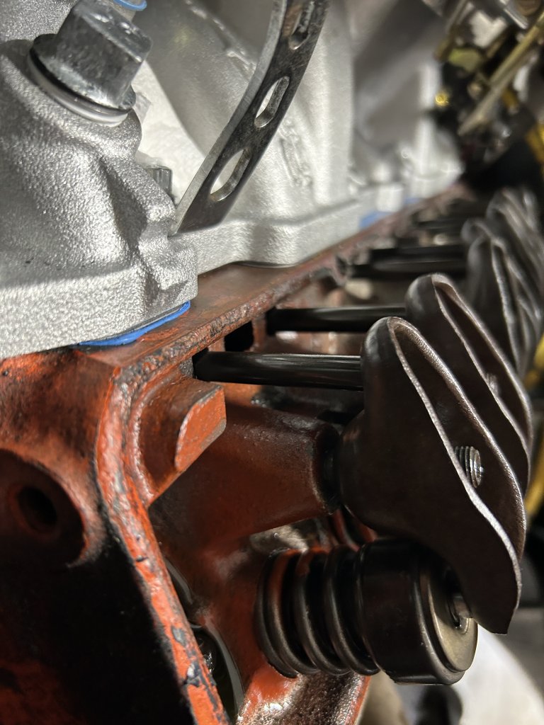

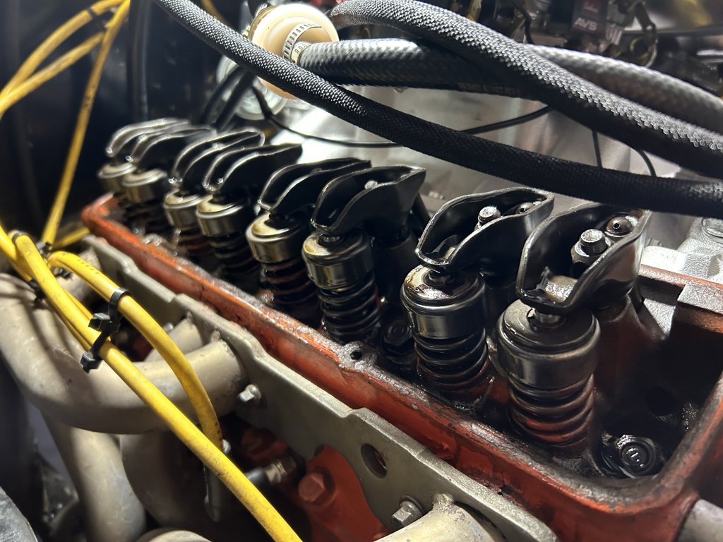

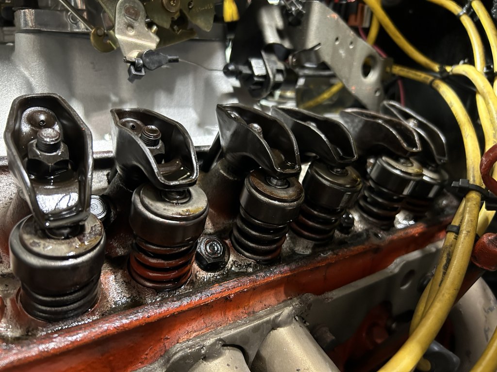

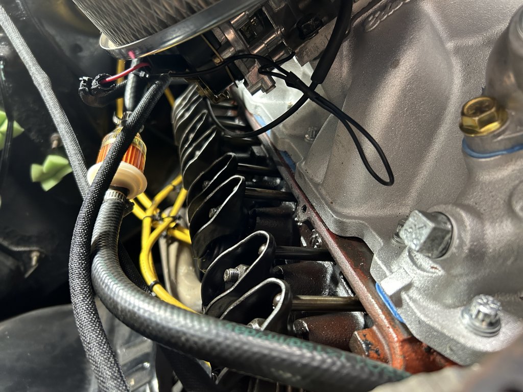

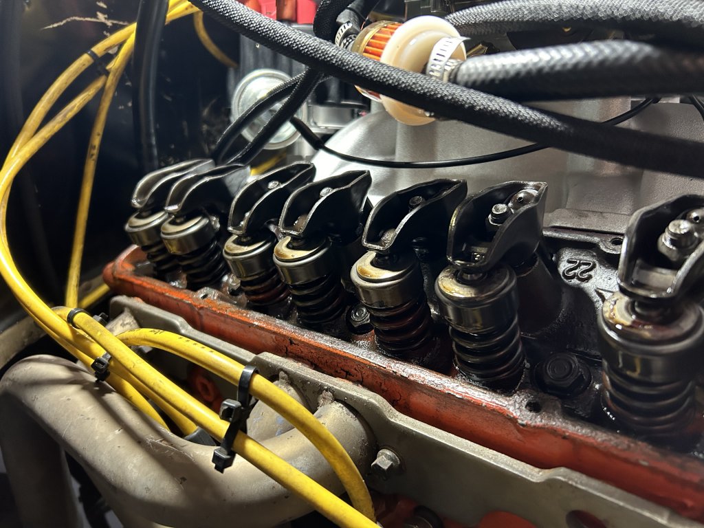

Attached are pics of what I see…

You can grab each pushrod and see if any are loose. Easier option is disconnect the ign power wire to your HEI (or coil wire for non hei) and have someone crank the engine over while you watch the lifters. If any aren't moving, you have a problem.
If a pushrod is bent and off the lifter, or a lifter came apart or isn't of its bore, you can lose oil pressure.

I did pull the valve covers and cranked the engine over and all rocker arms and push rods appeared to be operating normally.
