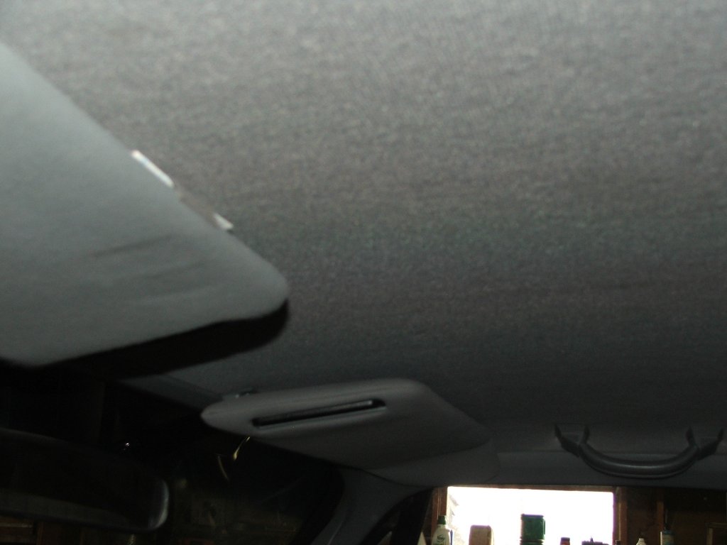

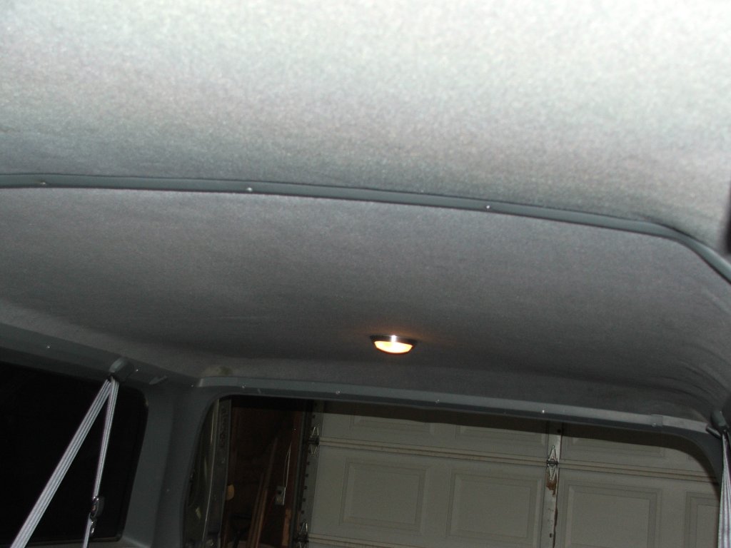

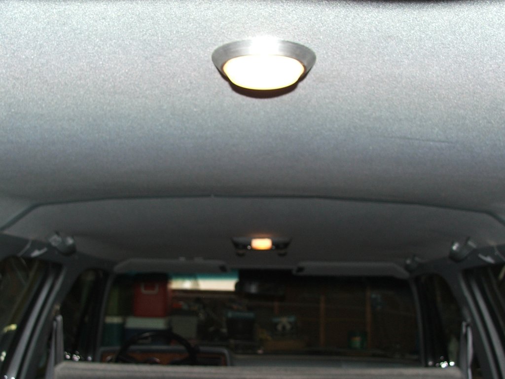

I just did a 90 Suburban using the old cardboard backer.
Remove it from the vehicle.
I peeled the old cover off and used a hand wire brush to scratch off the old foam to get down to the cardboard.
The cardboard needs to be dust free.
Then find headliner glue, which is a super contact cement that will not let go due to the high heat of summer.
Glue it on per the instructions and reinstall.
I bought my headliner material at Hobby Lobby.
A Suburban takes a lot.
