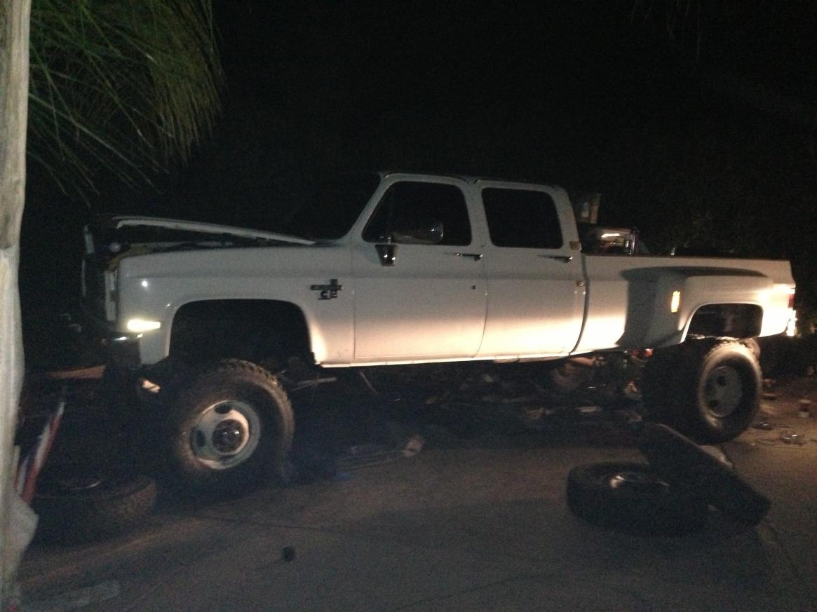

Lifted my truck today but have a problem is this right ?

can you put them in backwards? I was thinking that might put the center pin back more and get the tires in the right spot.

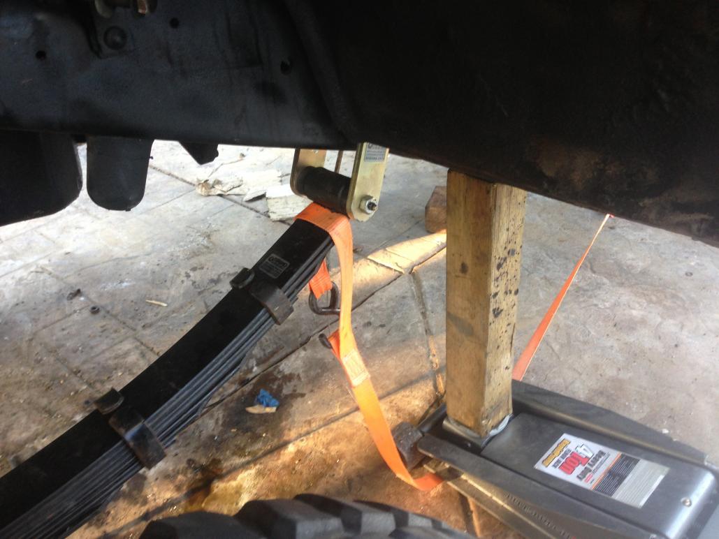

When I called them they said to compress them a rachet strap the shackles back I haven't had time this week but ill keep y'all post on what I do with it . I only have this problem and drive shafts to make longer in front and shorter in back then she is driving !!

those are not the correct springs for your truck your axle sits way to far forward
47,132
9,327
That's no lie. Looks to be at least 3 inches to far forward, probably closer to 5 inches. Looks like the front of the tire would be into the side maker light if it wasn't lifted. Not even close to center of the wheel well.
24,809
6,738
Dude, something way wrong there. Tell the ******** that sold you those springs to stick them up their ass and get them somewhere else. She does look good otherwise! :D

Wheel is way forward....
....yup.

Are the front spring hangers in the stock location? It was mentioned earlier but maybe the front spring hangera have been moved forward for a 52 spring swap.

Y'all have got to remember he said he ordered these springs with a custom center pin offset.
I'm still betting that if he'll work on unlocking the shackles the spring may lay down both moving the axle back a little and end up with an acceptable shackle angle.

Yea it's just been a busy week end . Yes I did order them with a forward off sett from the center thought it would help the stance a little but kinda makes it look dumb ...but this week ill get out there and take the weight off of the springs and see what's going to happen ..

Fixed ! They just needed to be pulled down !

The shackle angle looks pretty bad right now... I thought the motor was in this thing?
