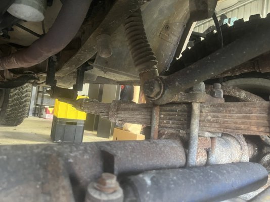

Good morning all the way from New Zealand. I’ve just bought this K20 as a fresh import into the country.
I’m looking at replacing the suspension as it’s current hacked and welded.
I’m thinking of doing a shackle flip in the rear + a 2 inch lift (56 inch leafs). And 6 inch in the front.
What’s everyone’s recommendation for smoothest ride and good articulation.
I will not be hauling any weight, will be mostly off-roading. Will be adding a Baja style bar with lights and winch on front. I plan on keeping it on 37/12.5s. I’ve also adding a bushwhacker cut out flares. (Tyres can’t stick out past guards in NZ)
Thinking about a sway bar disconnect and crossover steering kit also. I have to import everything by container so only want to do this once.

Thanks. It’s got 4 inches of blocks in the rear and the front leaf shackles have been cut and extended with 1 inch box section.
By ORD do you mean offroad design?

Welcome to the site from Central NC. That's a great looking ride you have there. I'm sure that "hacked and welded" is not going to be an issue until you get a few miles into the trail... I like the idea of the shackle flip and reducing the size of the block. I don't know exactly what has been done on the front. Send some pics of that too so that these folks can "examine and diagnose" the fail or weak points.

If staying leafs, Alcan (ORD) or Deaver both produce pretty flexy leafs.

New fenders aren’t to hard to source here or to expensive so I might even buy another set incase one day it becomes a mall crawler. I’m looking at either a skyjacker or ez-ride 6 inch lift now and will be trimming the fenders as well.

Very strict regs in NZ. Any modifications from original design requires certification (from a automotive engineer.) As well as 6 monthly warrant of fitnesses (checking brakes, bushes, rust, damage ect).
Can’t even register it until this is completed.
