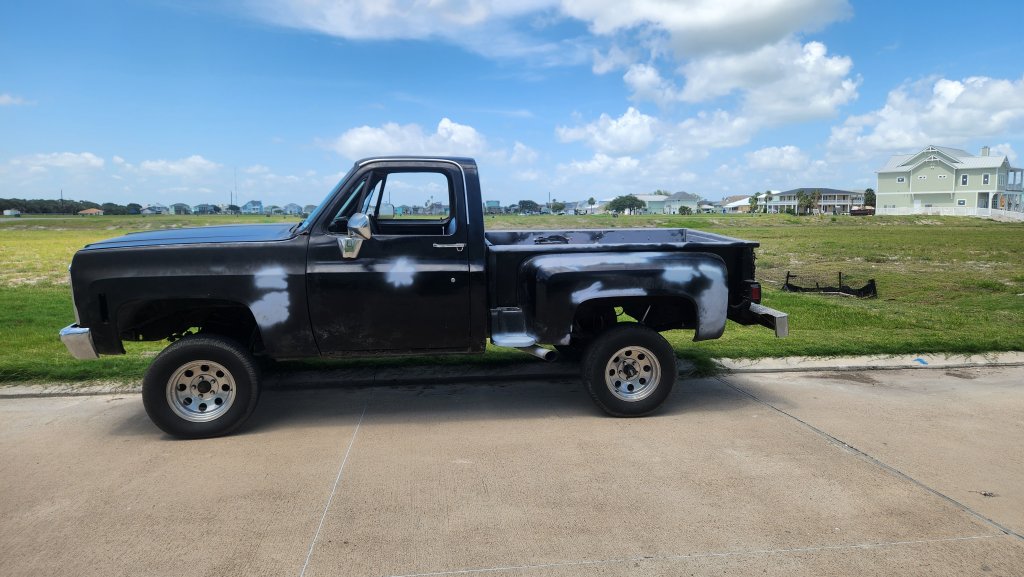

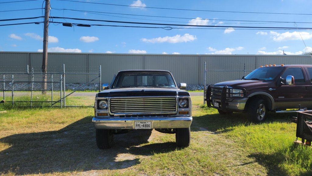

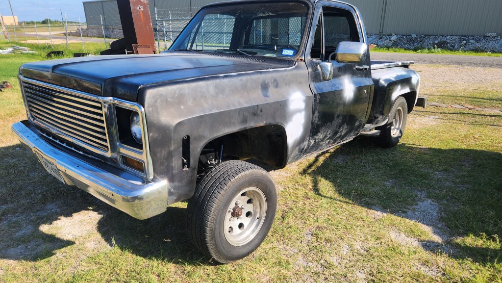

Just want to make shure im reinstalling new control arms correctly.

Squat.

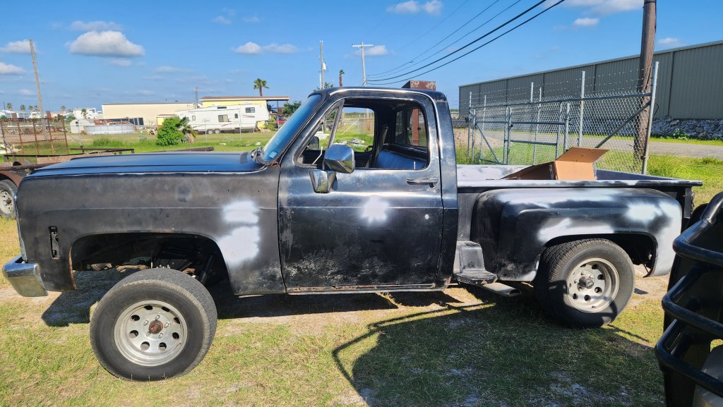

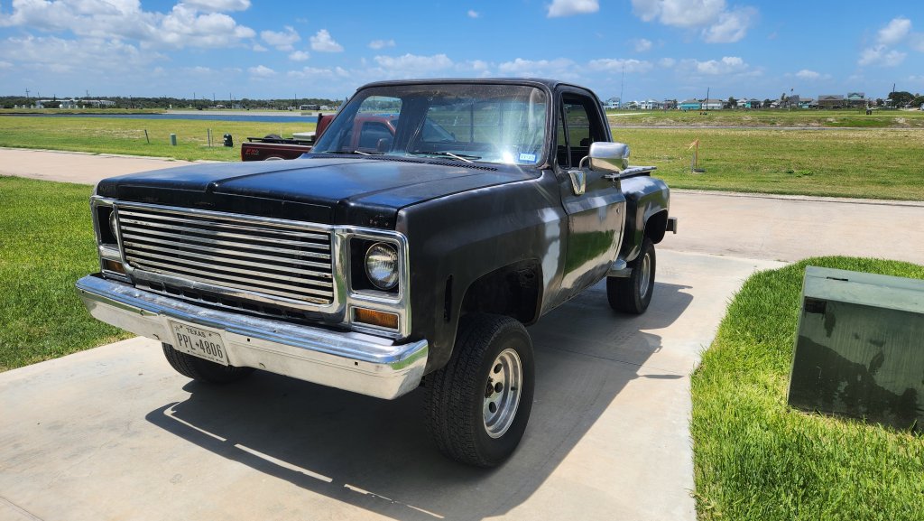

All done. 37.5" front 37" in rear.
