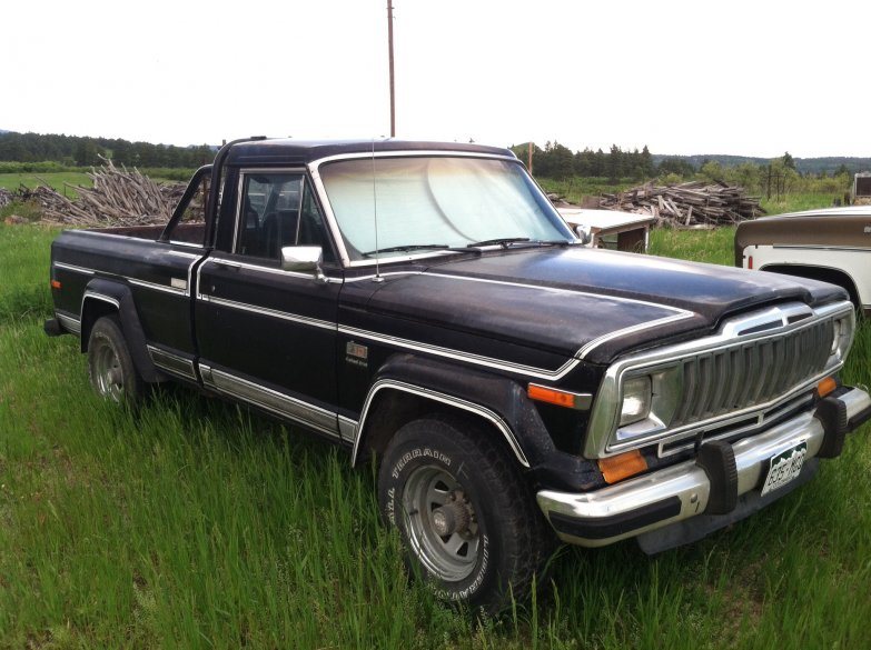

Also a pick of my fsj. Love squares n jeeps
