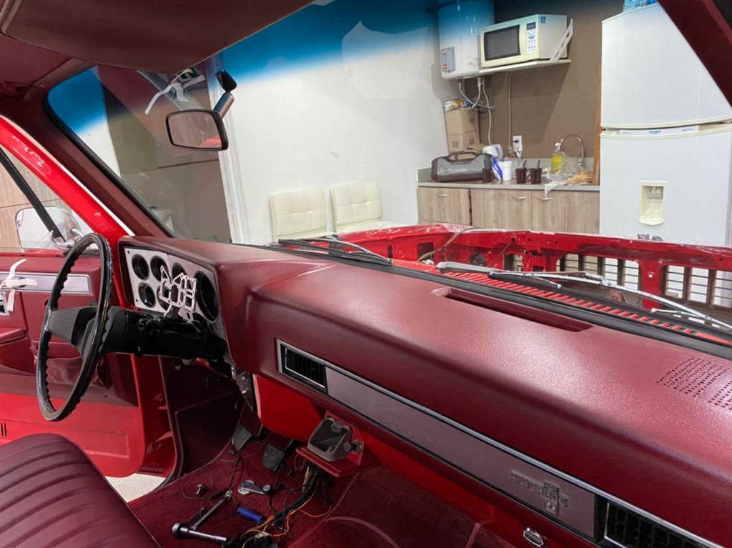

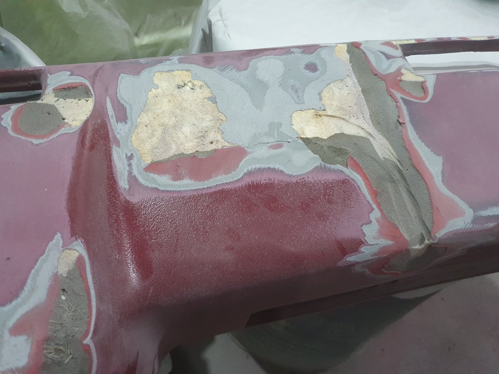

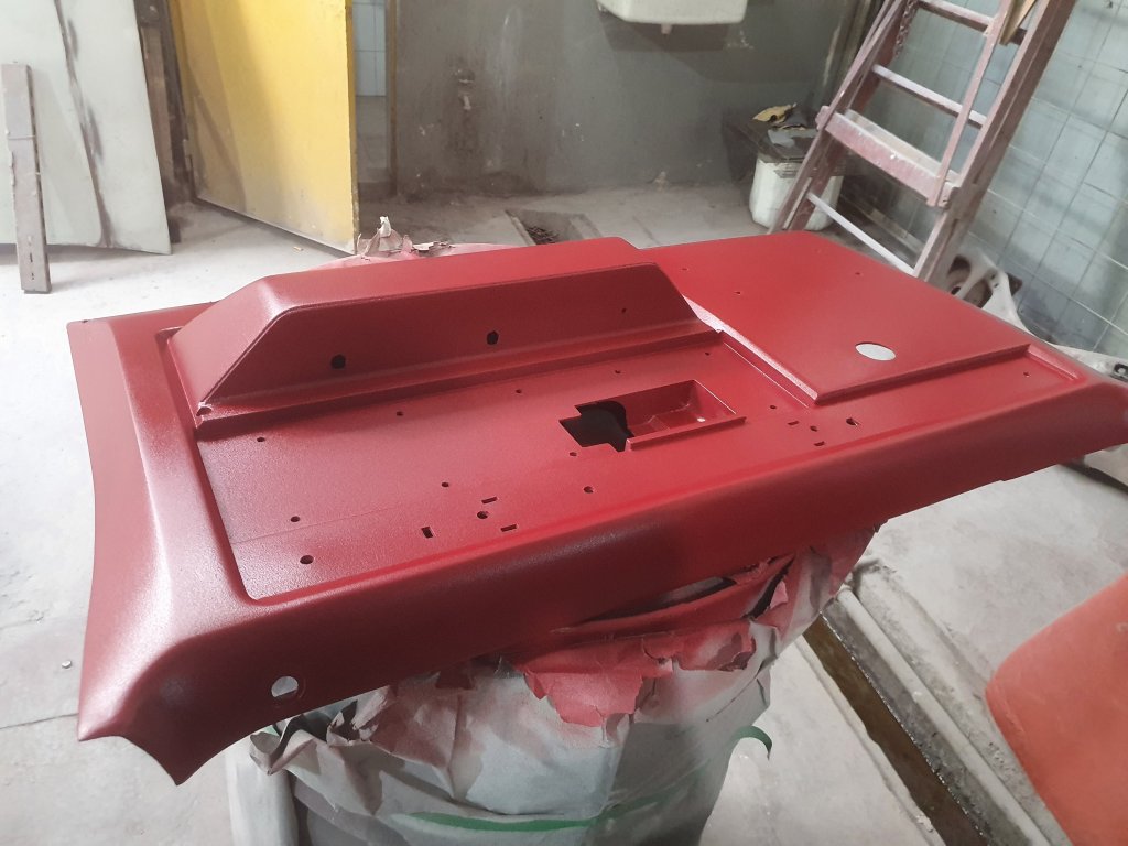

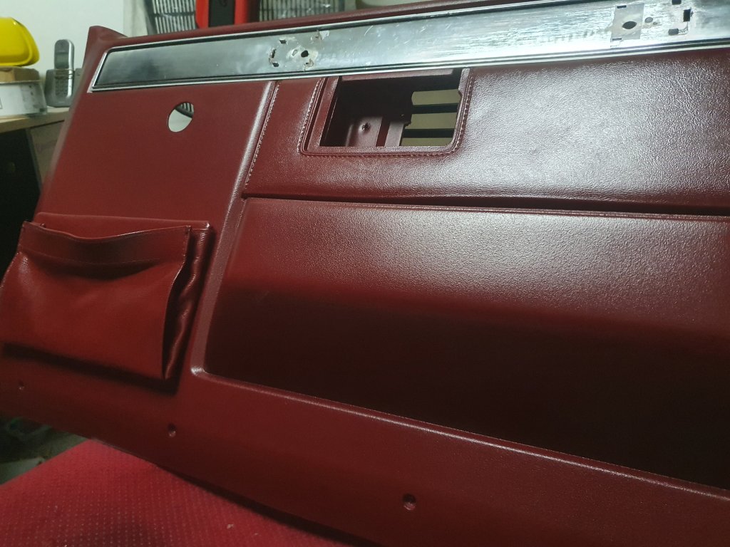

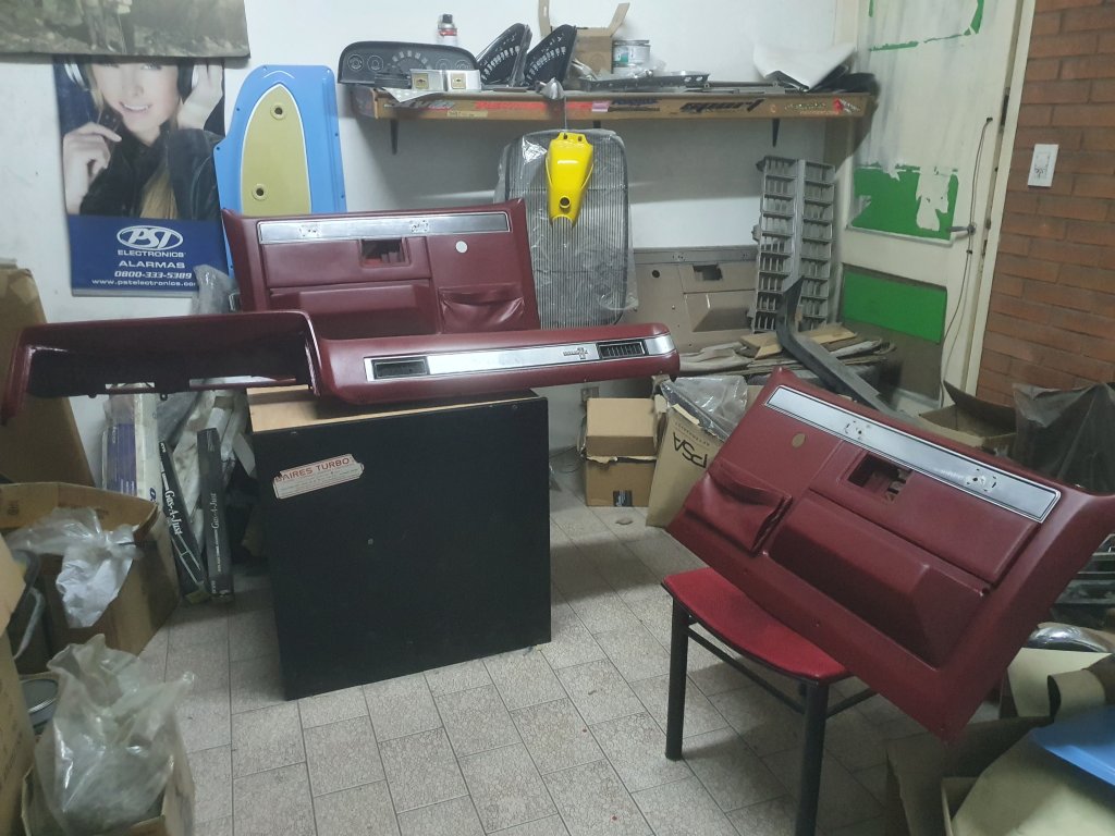

Looking for input on the interior panel paints offered by LMC and USA1. Refurbishing a daily driver/work truck and need to freshen up the 1983 Carmine Red interior. Given the use the truck will get, at this time I'd rather rehab my sun bleached door panels, etc., then buy new.
Are they similar products? The LMC Colorbond paint is in general colors (Red, Blue, etc.) while USA1 is listed as actual OEM color (1981-87 Carmine Red).
How well do they match original interior parts? What about durability? I came across a past post where someone had repainted a door panel and the finish was starting to bubble.
Thanks!
question, can't you prepare the color in polyester bilayer for automobiles in a paint shop, here they prepare it for me with a sample of the same tone, then I paint and that's it
