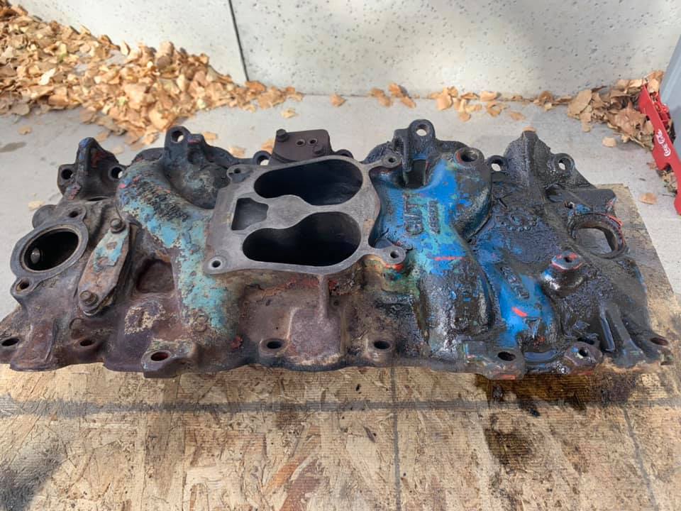

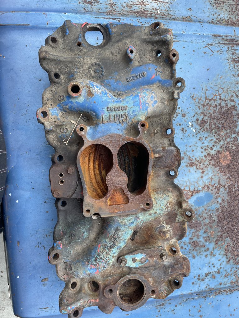

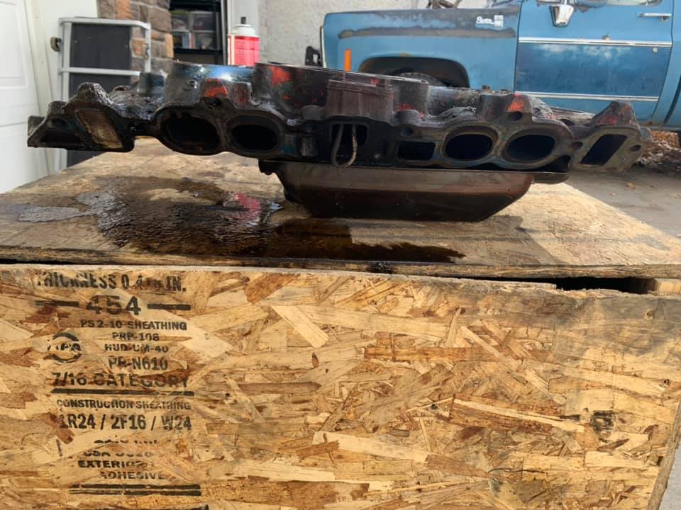

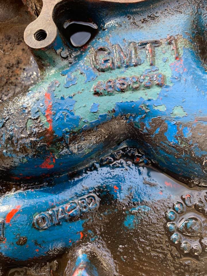

Trying to find a OEM non-egr (EGR is routed to the smog pump) intake to replace the washed out one.
I have the factory intake for a 454 with peanut port heads. I replaced it with an Edelbrock intake when I dropped a reman 454 in last year. The only two issues are the front water pump bypass fitting broke off and the threaded portion of it is still inside the manifold. Second, its a little rusty and would need to be cleaned up, but it’s just surface rust. It sat around for a year because I never intended to reuse it. Tried selling it on the local buy and sell groups, but no one wanted it. Only thing that keeps me from junking it is I hate throwing away something that is still usable. These are older pics from when I tried to sell it last year. I’m away from home and can’t take a current pic at the moment.

Some small blocks in the 1980s had aluminum intake manifolds from the factory. Was that also the case with big blocks, or were they used only in the late 60s/early 70s on high performance engines? Of course, if it was a factory manifold it would probably have a GM casting number on it somewhere. Nice-looking truck!

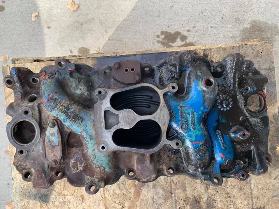

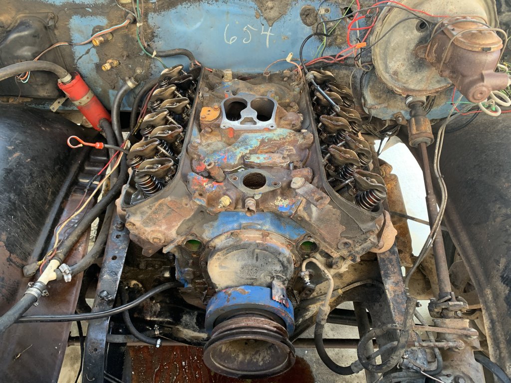

Looks to be in pretty good shape, are you still thinking of selling it?
Here is a current pic of it. Like I said earlier, it’s been off for a year now so it has some rust and will need to be cleaned up. The front water pump bypass fitting still needs to be removed. Otherwise it’s good. You can have it if you want to pay the shipping.
