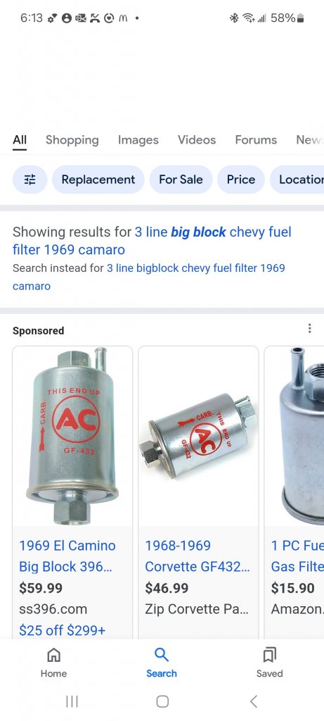

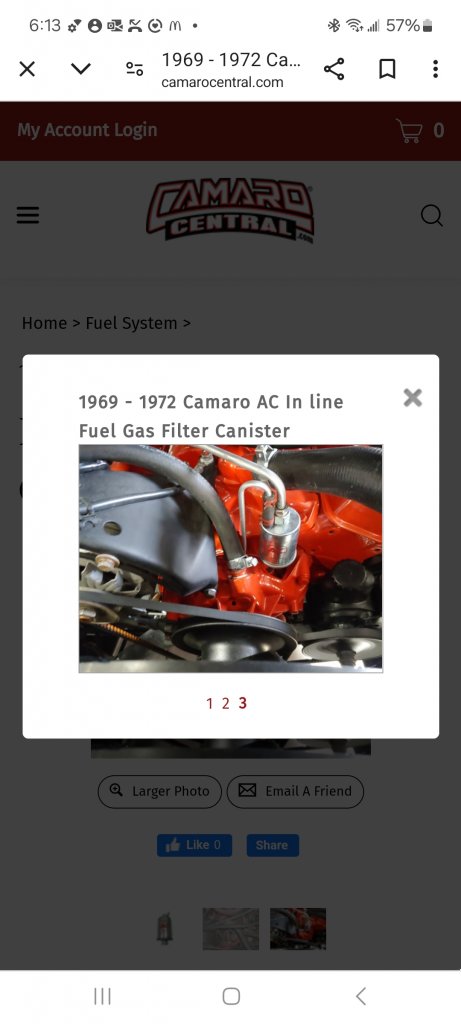

Yea, but my concern on his situation is that he's running it at the pump inlet,so if he hits a bump etc. he is possible sucking air,not fuel,for just a second. I'm not sure if that brief interruption is enough to lose prime on the fuel pump. If you position the fuel filter so the outlet is facing up it should fill completely,on its side air gets trapped because it rises to the highest point. Another little tidbit if you have a plastic and paper fuel filter,sideways and it's more than 1/2 full it means the paper on the bottom 1/2 is clogging and fuel is having to find a spot higher up to pass through the filter.
5,387
8,594
Look at these pics. This is how GM dealt with fuel vapor. With the filter on end all air rises to the top and can bleed off and the filter will completely fill. Same principle as brake bleeders,they have to be the highest point of the caliper or wheel cylinder,or you won't get all the aire out.
