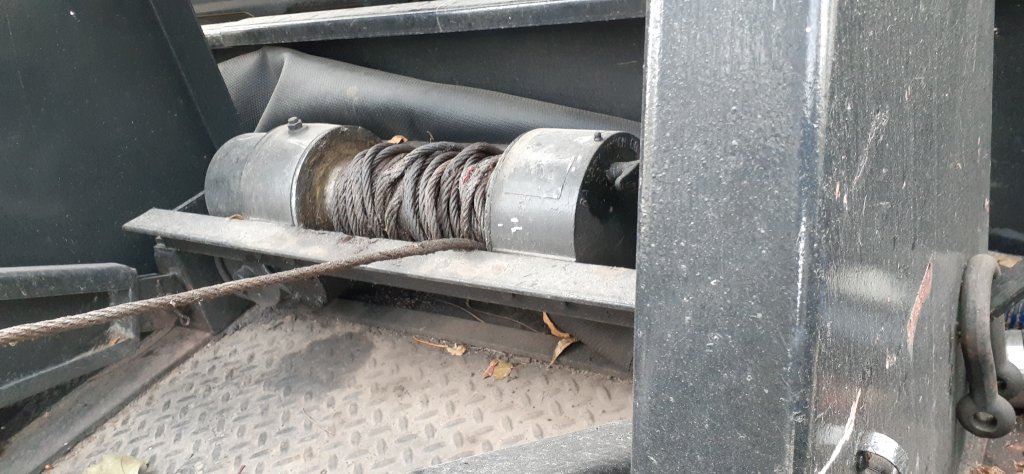

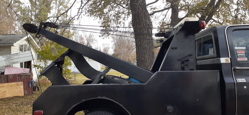

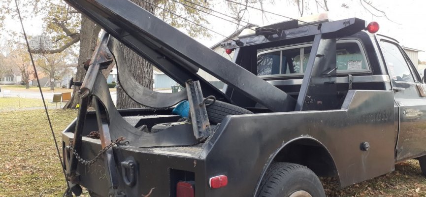

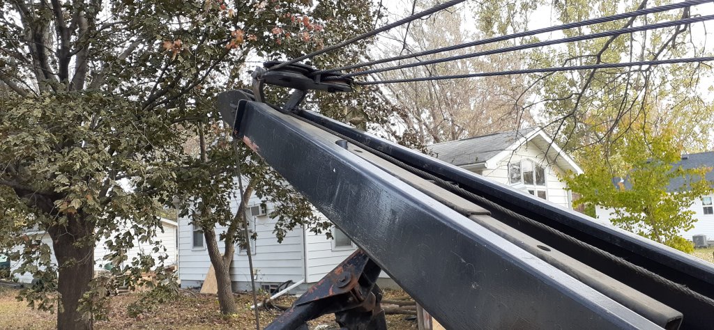

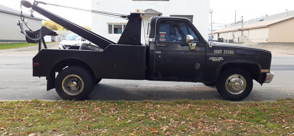

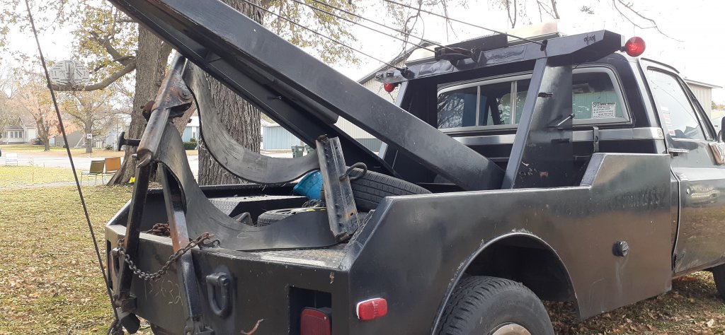

I have a 1987 chevy C30 sling back tow truck that I picked up to fix up and maybe take it to shows next year and maybe a little personal work with it. Is there anybody or groups that can help identify what type of tow bed it has and what the capacities are ? It is a single line manual boom with electric winch. Ive had one guy that says he knows all about holmes wrecker beds and swears it is not a holmes. Ive looked at a of trucks on google and havent seen anything the same as mine. Any help would be very appreciated.

Like it, I owned a towing co. That is not a Holmes but have no idea what it is. Does appear to be factory built and is an excellent design. Something is going on with the cable rubbing the mast. Cable wound wrong direction possibly? Sling is a Holmes design. Doesn't appear to have been used much.
FYI-those 60" C-A trucks can't handle much weight. Lighter vehicles only. If new to tow trucks stopping with a load can be an exhilarating experience. Especially winter driving, no ABS. Most states now require graded tow chains with ID and safety chains.

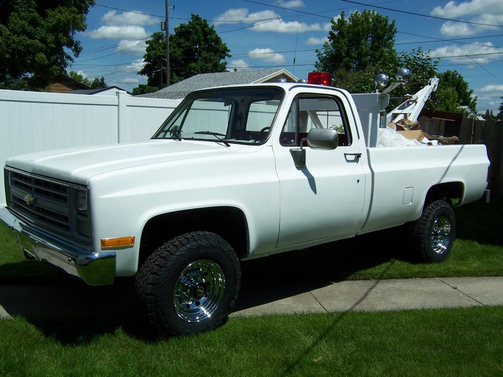

Below is mine bought new restored last year.

Thank you for noticing the winch cable, I havent seen that yet. This is the first tow truck Ive owned so I dont understand what you mean by 60" C-A truck. Also truck wont get driven in winter, but Ive been driving MN winters all my life ( Im 53 years old ) most of it without ABS equipped pickups. ( I hate ABS ). I will be rewinding the cable, Thank you. Ive also already purchased a new set of j-hooks with chains from Zips so I should be good to go there, they do have tags on them. You are giving me great information, Thank you. Your truck looks great.

60" is short wheelbase, next longest is 84" We primarily used short wheelbase trucks for local in city car and compact truck tows. Obviously longer would have a larger turning circle. If it were me I would replace that cable. Remember if it breaks bad things will happen. Zips has premade cables.
The term CA refers to the cab to axle measurement. Back of the cab to the center of the rear axle. Very important number for body up-fitters.
Yeah it's either bird nested or wrapped wrong for sure. Once he drags the slack out and unspools some it should be apparent. Should be unwrapping off the top.
