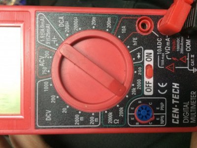

What should this be set to for testing coil and distributor power wire.

Looks like the coil is good if I'm using this meter correctly..how do I check for 10 volts at the b+ ?? Like what do I set this meter at?? I don't no what this stuff means ..dcv?acv?dca? The hei was properly assembled I did it a few months ago and it has been a daily driver since. One cold below 0 morning I went out to start it with no luck sprayed some either in it and somehow blew a fuse ne'er the starter and had nothing at the key. Replaced that now I lack spark. But looks as if I have power at the distributer while testing with s light tester is it enough? I'll let you guys no wen I figure out what to set this meter to... If anyone knows there are pictures of it above.

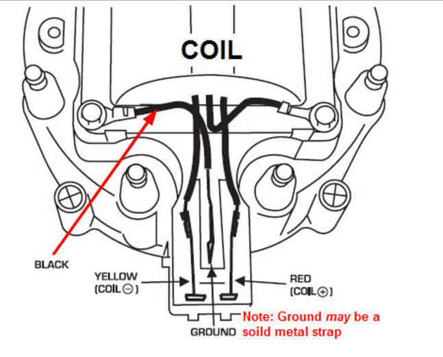

Or you switched up the terminals when you put it together. Start by checking that all is as it should be and that the ground strap is present.
dcv = direct current voltage (as found in automotive applications)
acv = alternating current voltage (as in household electrical systems)
dca = direct current amperage
Current is simply the term used to describe the movement of electrons within a conductor (a conductor is a wire - for this discussion). And, when there are a series of conductors and devices that are connected together to form one continuous, unbroken loop - that is called a circuit.
If the electrons flowing in a conductor are continuously moving in just one direction - that's called direct current. And as above, if the conductors form a continuous loop - with the electrons flowing around and around in the same direction - that is called a direct current circuit.
In an alternating current circuit, everything's the same as described above for a DC circuit - with one major difference. The electrons flow first in one direction for a certain distance. Then they stop, turn around and begin flowing backwards through the conductor - opposite their original direction. They keep moving backwards until they get to their original starting point. Then they stop, turn around and begin flowing in their original direction.
Being an electron in an AC circuit kind of sucks. They move just as far and do just as much work as the electrons in a DC circuit - but they never get anywhere.
Think of voltage as the water pressure in a garden hose with a hand operated spray nozzle at the end. Even when the nozzle is turned off, there's still pressure in the garden hose.
Even when a light is switched off there's still voltage in the energized portion of the circuit.
Think of current as the flow rate of water in the garden hose - like how many gallons per minute are moving through it. When the nozzle is turned off, there's still pressurized water in the hose, but there's no flow.
When a light is turned off the electrons are still in the wire, but they aren't flowing anywhere -- there's zero current.

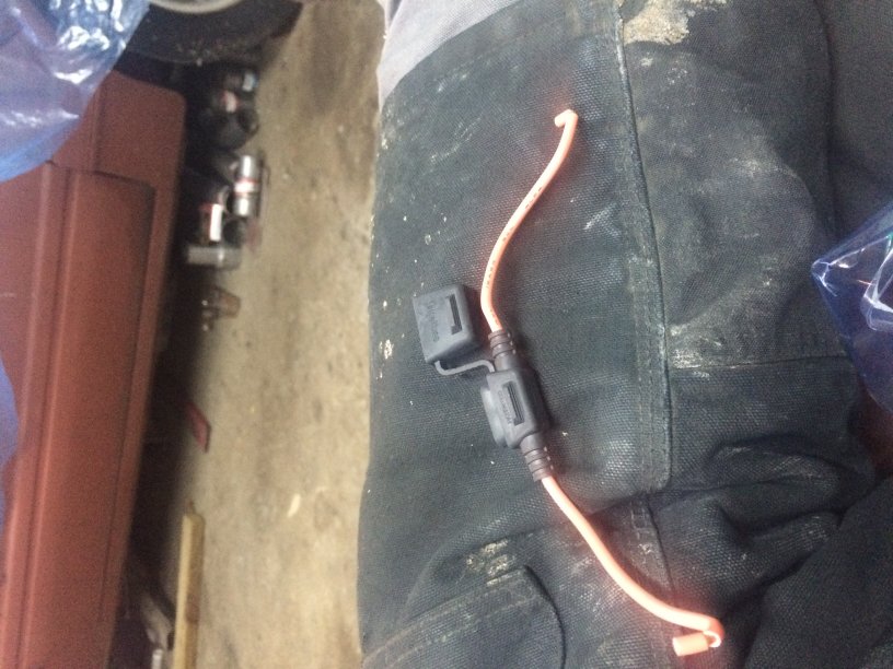

As far as the blown fuse goes..I did it have a fire but a month ago I burned a wire on my header and nocked out my headlights ms the inline fuse I replaced the fuse with a diffrent style cause I couldn't find on at the auto parts store that looked like a factory one so wen I went to start it for some reason it popped is this style ok?? I put a 40 use in it

Fusible links are simply short lengths (less than 9 ") of insulated copper wire. The cross sectional diameter of the copper conductor is sized to overheat and burn/melt when an over-current condition exists in the circuit it protects.
In your truck, the wire gauge (expressed as mm squared) of the two fusible links - down by the starter - are 2 & 1:
Wire size conversion table (mm squared to AWG):
Replacement links are available at any common auto parts store. Here are the two sizes (14 & 16 AWG) used in your truck - as shown at Autozone:
I would remove the in-line fuse and replace it with the proper sized fusible link. First determine which link melted. If you saved your OEM link just check the rating on the load side splice casing:
If that is gone, check the rating of the remaining one and...it's not that one. Another hint is that; the 16 AWG link is immediately split off into two separate leads on the load side:
Butt splices are included with aftermarket replacement links, but they should be avoided. The preferred method of inserting a link is by soldering it inline and insulating the soldered joints with heat shrink tubing.
