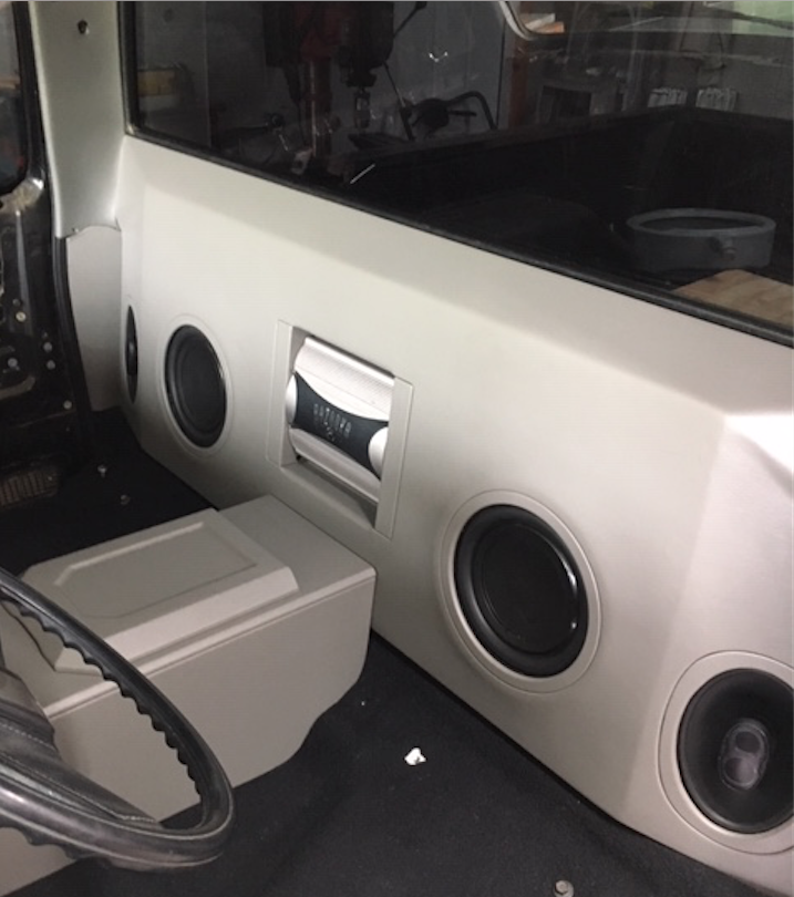

Here's my setup.

Here you go. JL 13" shallow truck sub with custom box to spec. with the seat all the way back. JL 600W Amp. Stinger Capacitor felt like I bought a bigger amp and stopped the dash from blinking when I turn it up loud. Kenwood 4x9s and Kenwoods in the dash too. If I could change anything it would be component speakers instead of the coaxials, and the 13 can still handle more 200w juice at the OHM rating it has. I would like to switch the factory locations of the HVAC and Stereo, similar to @c10_pandemic on Instagram's setup. I am 6'2" and am sick of hitting my knee on the deck!

Great set up. Great picks. What did you use to secure the amps and sub to and how did you secure everything to the back of the cab?

Great set up. Like the place for the fire extinguisher. How did you secure it down?

get your sub box and mount a wide piece of plywood thickness of your preference to make "wings". mount them left/right of the box.
Velcro keeps the storage compartment secure and a couple of screws ( storage compartment to sub) keep the sub secure. Also, the back of the seat also helps. No holes in the cab.
