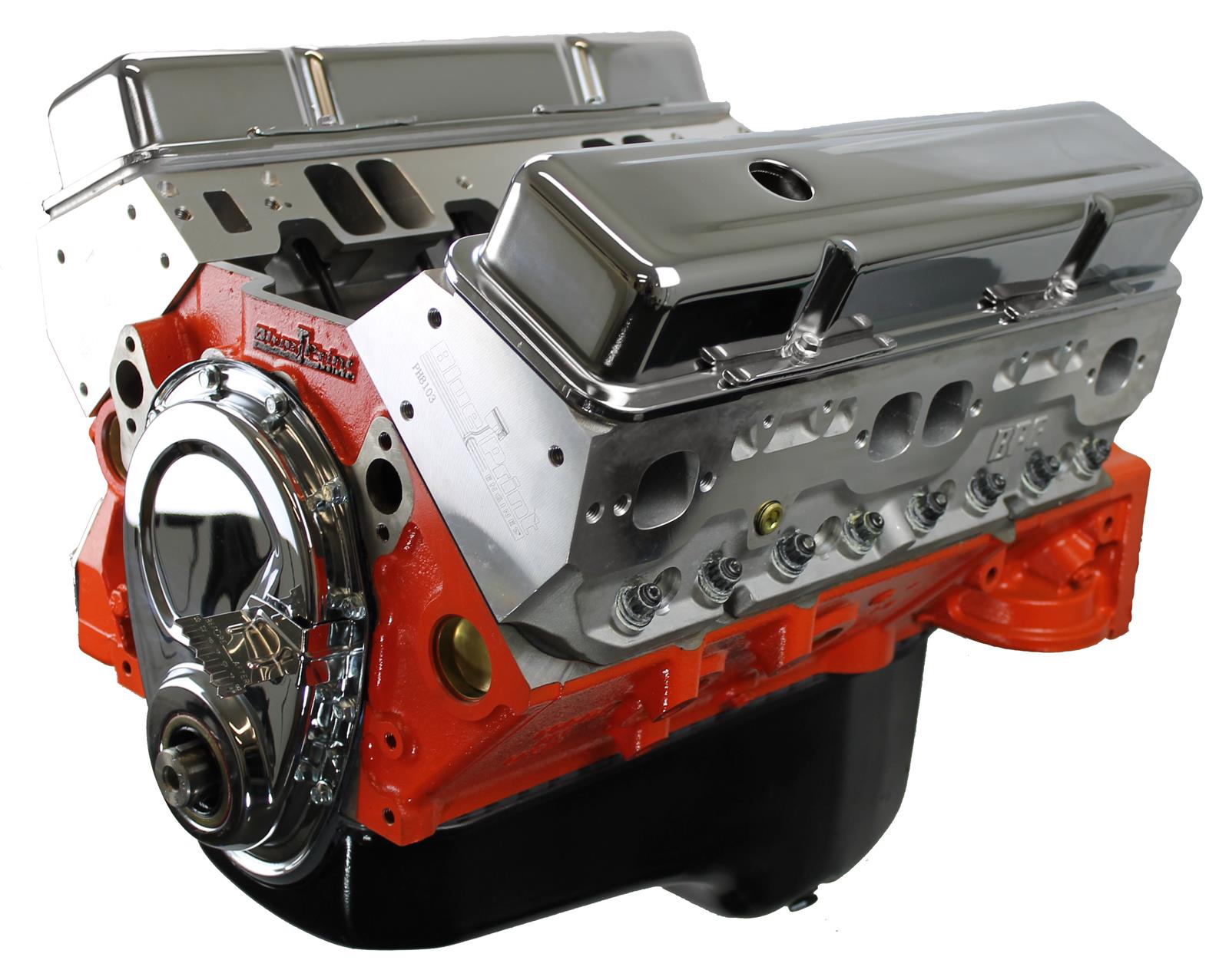

Glad you kept the AC. Good choice on the new motor. That thing makes 450 lbs ft from 2800ish to 5600 rpm. It's gonna be a blast with those gears. I dig the air cleaner element too. Keep us posted and let us know if or when the trans gives up. Your trans was built at one point so maybe it has a chance to hold up.

Thanks!!! I couldn’t build my current 400 to those specs for that price and It’s a new block, no steam holes, etc. thought about LS swap but that’s a lot of work to get everything working, gauges, mounting points, etc. I’d rather keep it small block 400 powered.

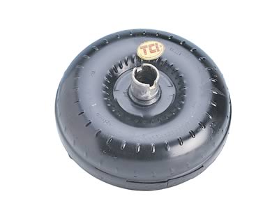

Have had the Blueprint 400 installed for over a year. Haven't put but 1k miles on it as it stays parked for the most part during the winter and I have other vehicles.
It runs very strong and the ol TH350 is holding up so far so good. I replaced the stock torque converter with this TCI 240900. It doesn't fully engage until 2400 rpm. About 1000 rpm up from stock. I've idled around offroad and can still crawl around at 1500rpm but when your on the throttle it lets the small block rev to 2200-ish, then really takes off.
