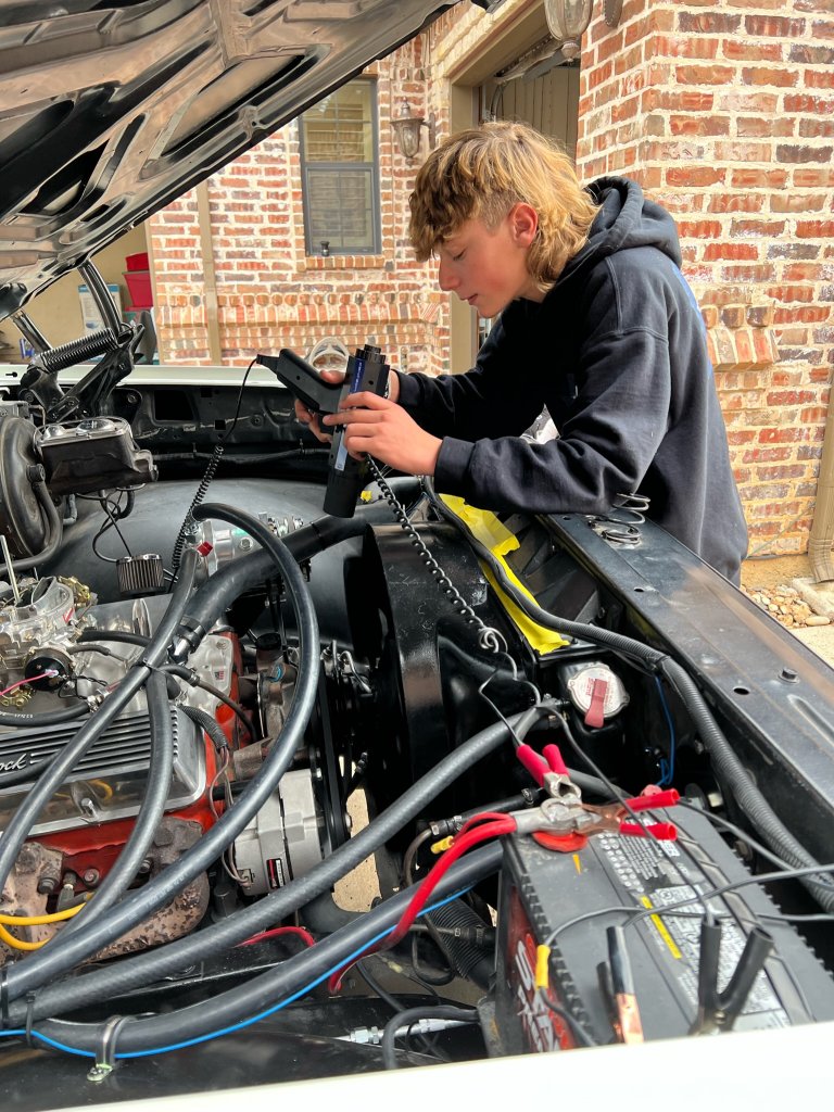

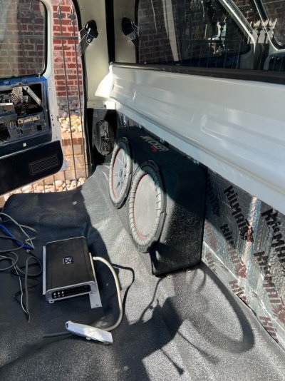

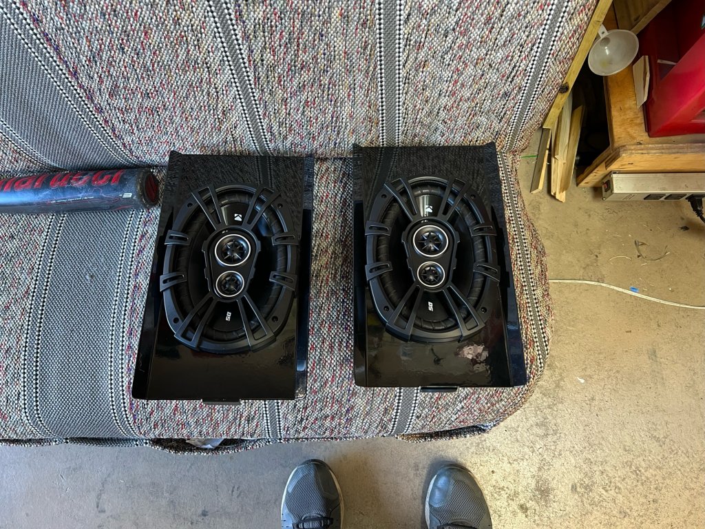

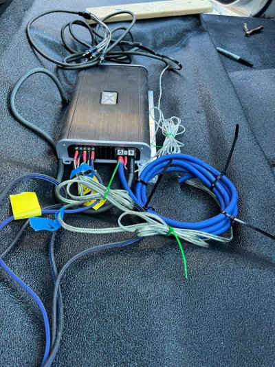

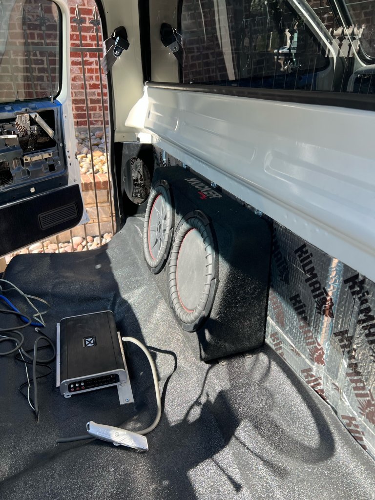

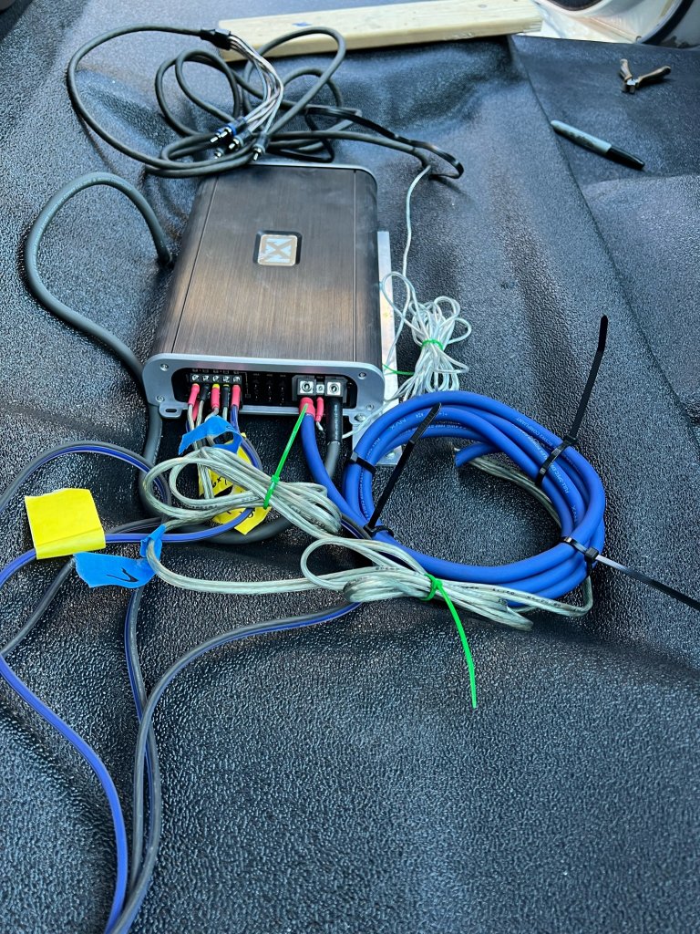

E just replaced his alternator with a part store replacement while I was out of town. Running a 5 channel 1500W amp with dash dual Chanel speaker, kicker 6X9” in corners an and two 12” subs behind the seat. It works fine, can usually hear him coming about a block away! So never checked the amp on alternator but it obviously can do it all.
