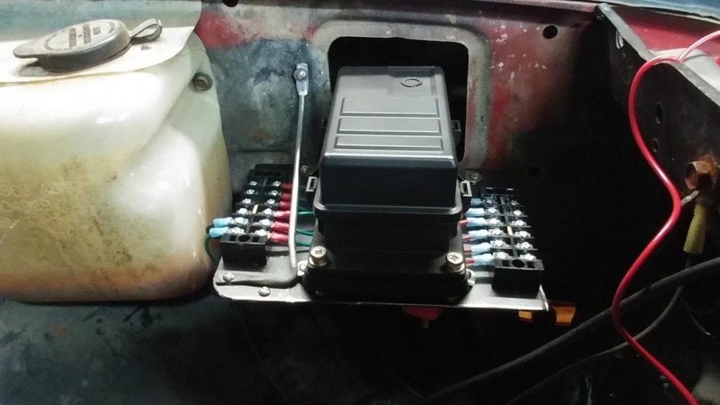

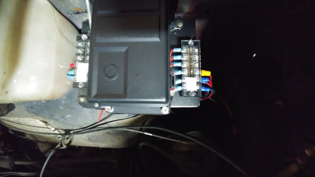

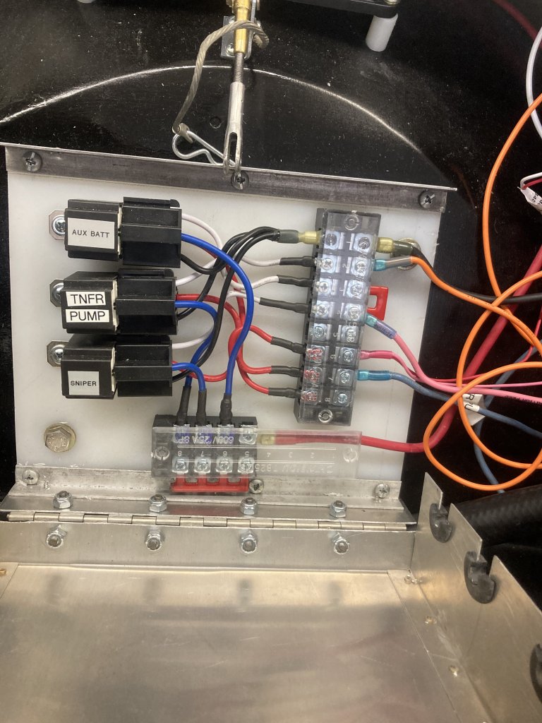

As you can see from the pic, this box is under the hood. I had to install a fuse box and relays in order to run the headlights and the power windows. The old stuff just kept failing and wasn't really up to the task anymore. Also I wanted a few extra relay and fuse slots on hand, for future upgrades. But as you can see, some of the connections are... kind of exposed under the hood. It's conceivable that dirt, fluids, and various other nasties might make it to these exposed connections.
How would you go about shielding them? There is a clear plastic cover over the top, but I'm a bit concerned about junk finding it's way in through the sides. The sides are just exposed to the engine bay. When I installed it, I made sure the whole thing can be easily removed. So that's not really a problem here. I wanted to be able to quickly detach it in case I needed it out of the way.
But I didn't really consider dirt and grime getting in there, underneath those clear plastic covers you see in the first pic. Now the more I look at it, the more I want to seal it off somehow. 1987 Silverado if that matters. Thanks!

SirRobyn0
Dec 6, 2019
6,755
11,402
Rob
Soldering the wires to the connectors (eyelets) and running shrink wrap would have been better than the crimp connectors in terms of protecting the wires overtime.
Assuming you want to protect the actual screw terminals I'd probably cover them in a good layer of dielectric grease. Yes, dirt and stuff will get on the dielectric grease, but it's easily wiped away or cleaned away with a little electrical cleaner. Liquid electrical like Al suggests is a good idea to, but the down fall for me anyway is that stuff is messy and has to be scraped up / peeled off anytime you need to turn any of the screws in the box. I think both ideas have pluses and minuses.

Most times I will mask off stuff when using liquid tape to visible connections otherwise it looks crappy. Dielectric grease I use on connections I'm pretty sure I'll be working on again. I keep both in syringes.
5,427
8,637
I would get some square plastic square tubing, cut 1 side out so you now have 3 sided deep plastic channel,mount it under the junction blocks,legs pointing up,now fabricate a cover how ever you choose plastic,more plastic tubing,aluminum,use your imagination. You can probably rob some from some old shelving. Well just found some pre-made probably cheaper than you can make.

My suggestion was gonna be spray paint as well.
Though Once you get everything hooked up to it, you reasonably shouldn’t need to disturb it much if at all.
If that’s the case I like the liquid electrical tape idea.
Dielectric will protect it as well. Maybe less messy, use Fluid film instead of dielectric grease?
Other suggestion, although you have everything wired up nicely, these little fuse boxes from Blue Seas are fairly well protected. It is still open on the ends where each load wire come out though.
Our truck, the electrical system is in very good condition but I don’t like tempting fate and adding “stuff” to it. So I put this in for all aftermarket accessories present and future. These boxes are only $35 iirc. You could make one constant lower and one triggered on with ignition via relay.
That would be slick.

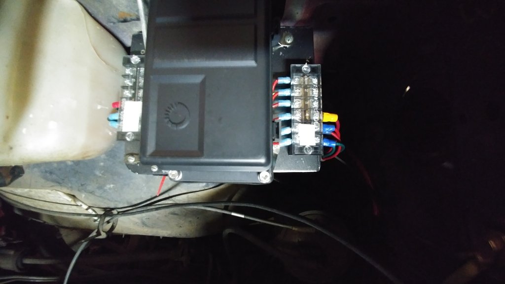

Go on Amazon and search for "electronic hobby box".

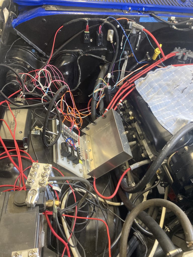

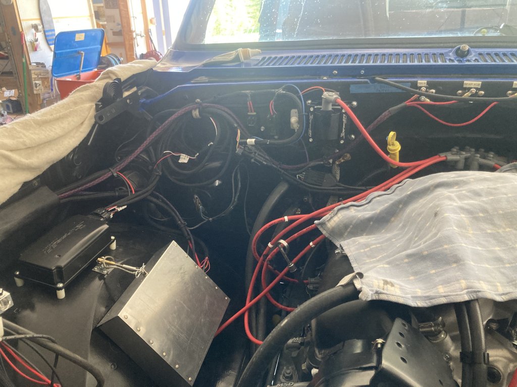

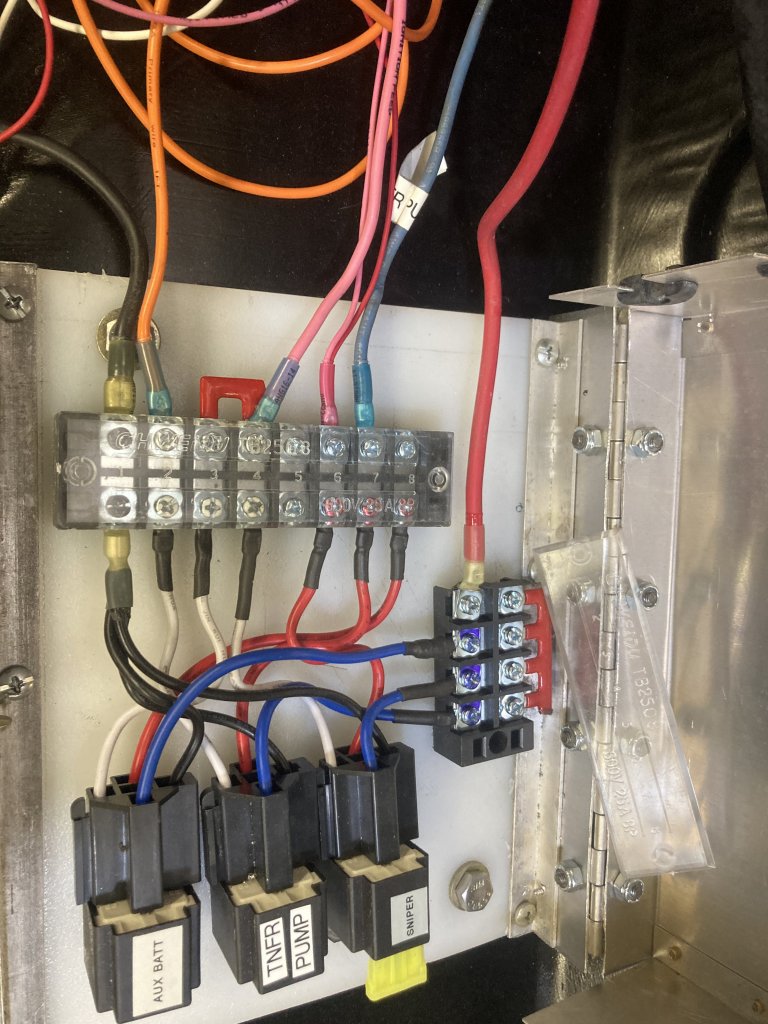

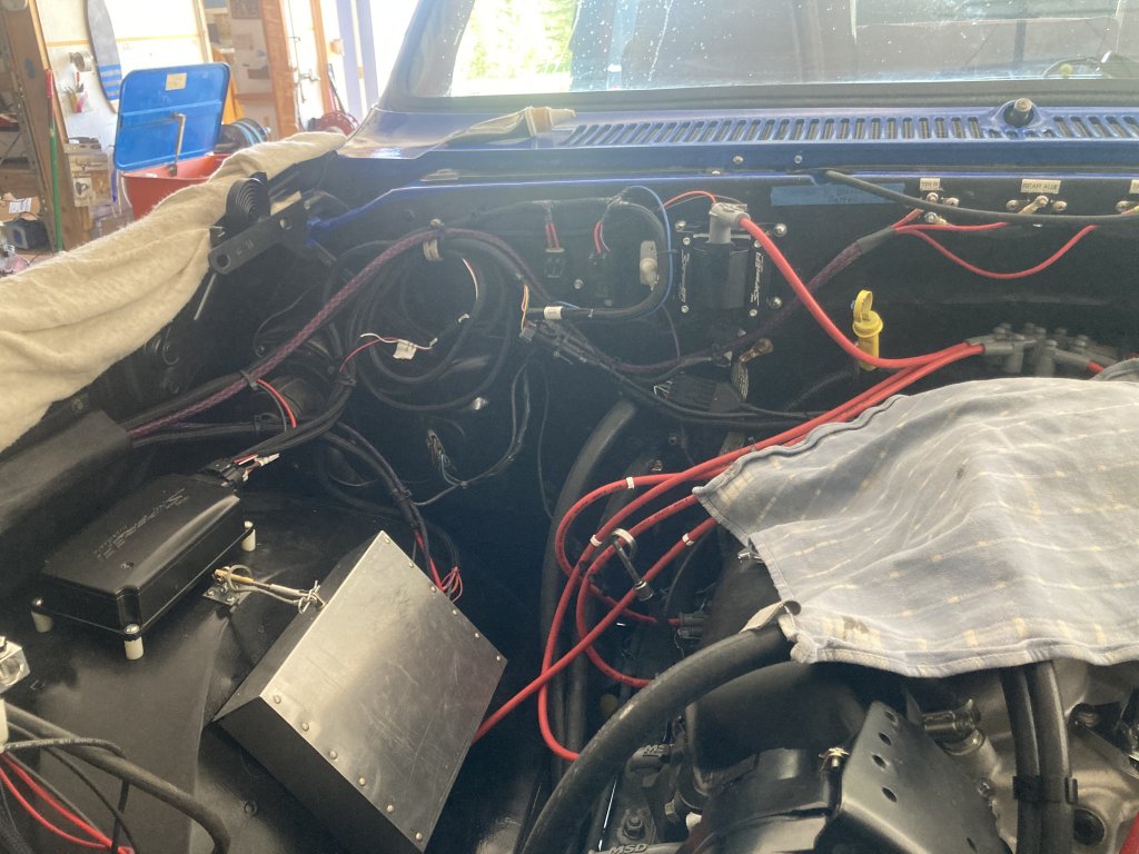

You have enough room on all sides to slip a bigger box over the whole works and seal it at the firewall? Here is what I did for a few relays.

Yeah I wanted to use one of those flat oem fuse boxes from the auto salvage yard, but they're really not made to be worked on easily like the aftermarket stuff is.

I have the exact same relay/fuse box and they are pretty weather proof. if you are worried about the attached terminal blocks you can just apply dielectric grease as others suggested but you will need to inspect regularly as some of it will dry out with high temps.
