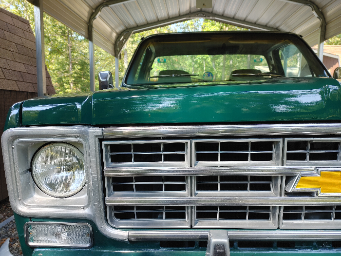

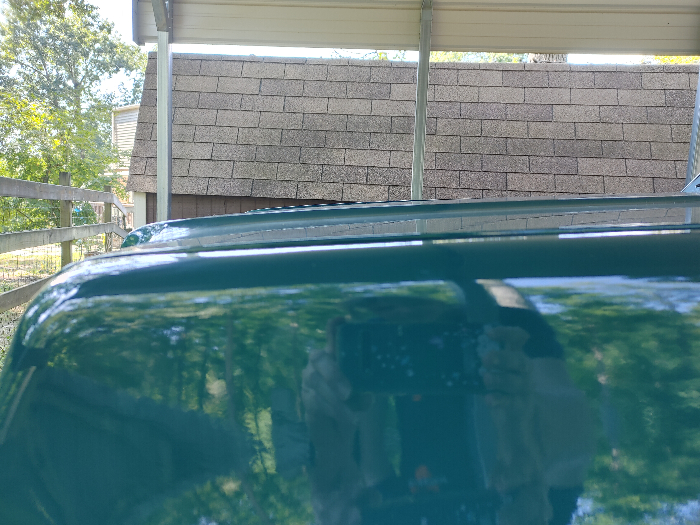

So I have noticed that my hood is not sitting flush with fender on both sides. My hood is not bent, I have the original hinges and have greased them up with white lithium. I bought new replacement hood bumpers for fenders. I thought they were too high so I cut some off the top. Didn't help. My hood has not been removed.
Any ideas/suggestions?

More pics. May be your hood latch.
If you haven't taken the hood off. It has to be the latch or the hood hinges. There's a little bit of adjustment in the hinges.

Are you certain it's the hood and not the fenders?
No part of the front clip has been removed, other than a grill replacement.

Okay, but why/how does this happen if nothing has been tinkered with? And how do I adjust?

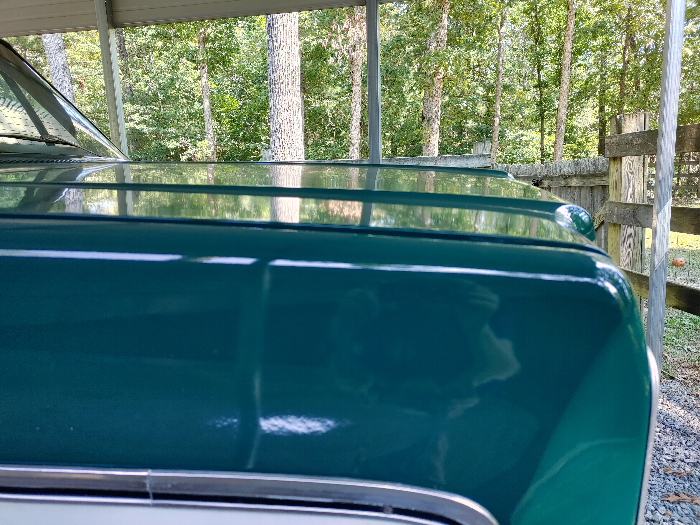

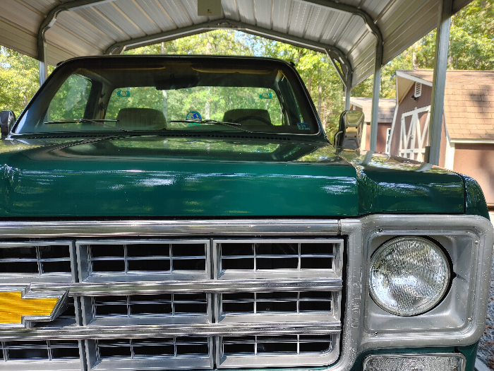

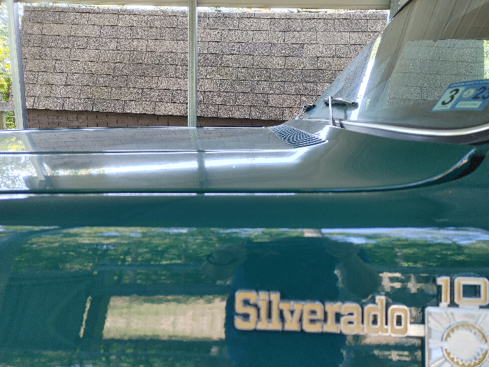

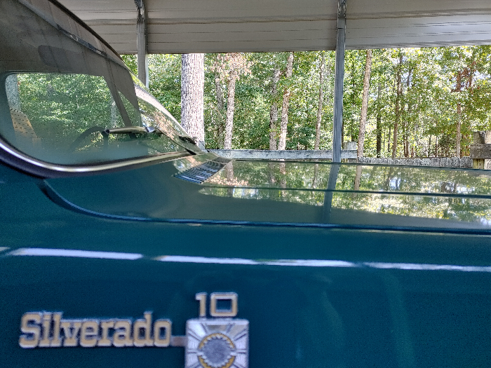

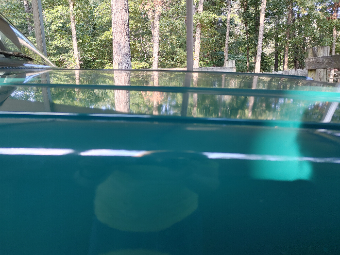

Got any pix of the front and rear of the hood?
My78truck
'Ol Holly
Apr 7, 2019
307
260
Virginia
Becky
C10 Silverado
5.7L
My78truck
'Ol Holly
Apr 7, 2019
307
260
Virginia
Becky
C10 Silverado
5.7L
Additional pics
Snoots
Jan 23, 2013
8,709
17,993
Roger
Jimmy Sierra
350 w/203
That I would say is 95% hinge wear and weak hinge springs. It can be adjusted out but that process I'll leave for someone more knowlegeable than I.

Ok, thanks. Do you think new springs would help?

Does anyone know where to buy "Made in USA" steel hood springs.........if there is such a thing?
