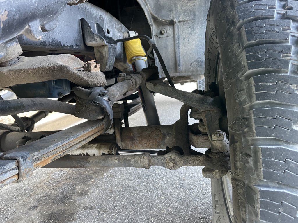

So...I am reviving this thread because I want to put 4" leaf springs on the front. Would anyone recommend just doing the leaf springs in the front (I have new shocks for a 4" lift)? What else am I going to need (ie. drop pitman arm, etc..)
Thanks for any help!
29,351
24,788
It looks to me like you have 4 inch springs already. Maybe sagged slightly. So it will basically be a direct replacement to go with softer 4" springs, assuming there is already a raised steering arm installed. In the pictures earlier, I can't tell.

Thank you for the reply...and sorry it took me so long to get back. Been out of town on business...
Anyway - I have attached a picture of the steering arm (which looks to be raised). The reason for wanting to replace the springs is that in an earlier post it appeared they were maybe 2-3" lift springs. As you can see from the picture the tire has been rubbing on the front drag link. As much as I hated to do it I had some 1" wheel spacers laying around and those moved the wheels out enough to clear that drag link. Now my issue is that it's rubbing on base of the fender.
