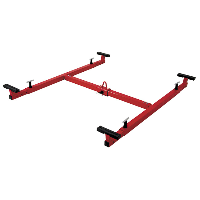

I've been thinking of getting one of these to use with an engine puller to do bodywork/paint.

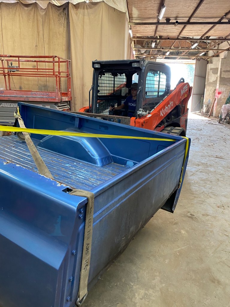

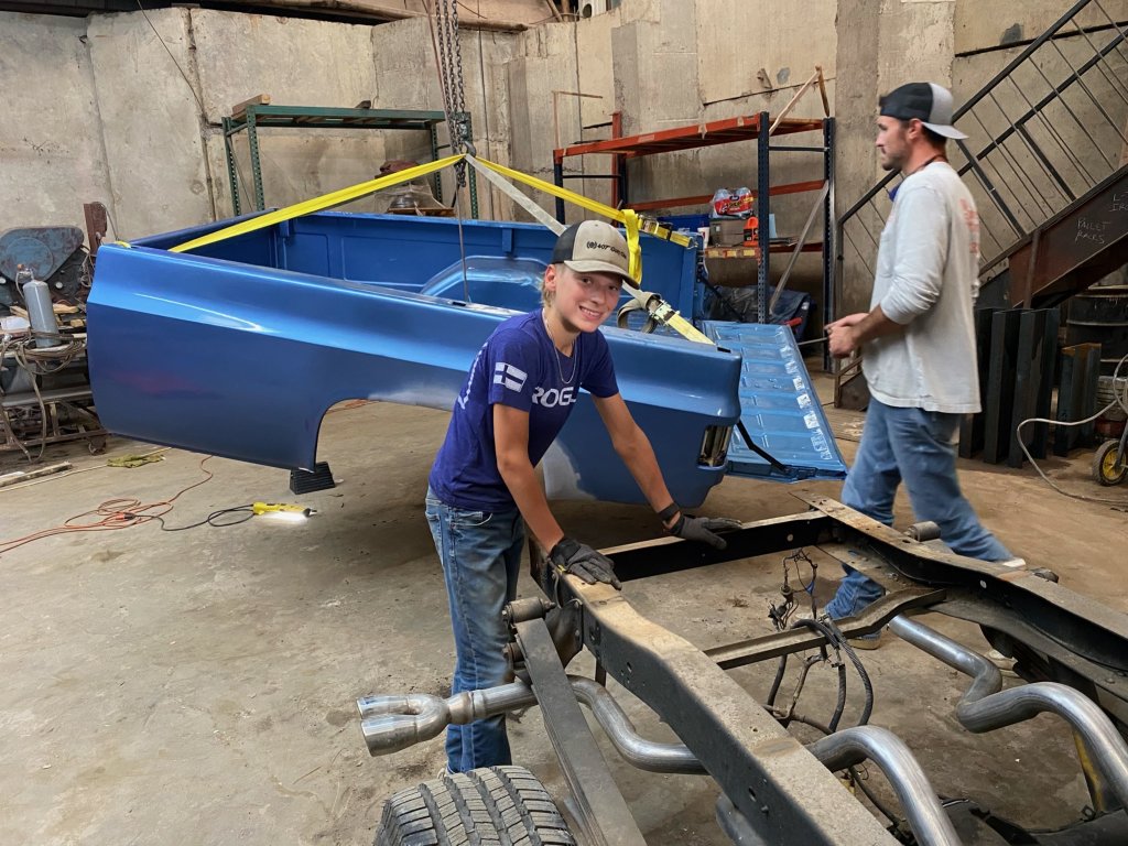

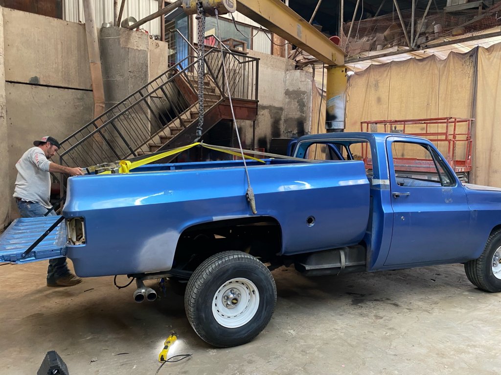

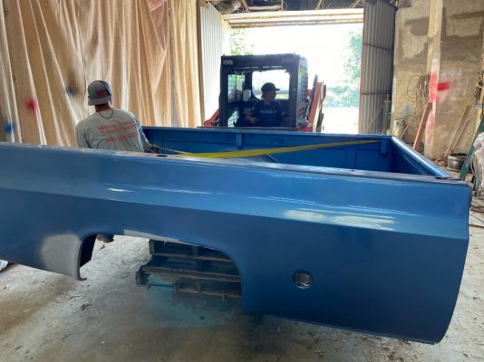

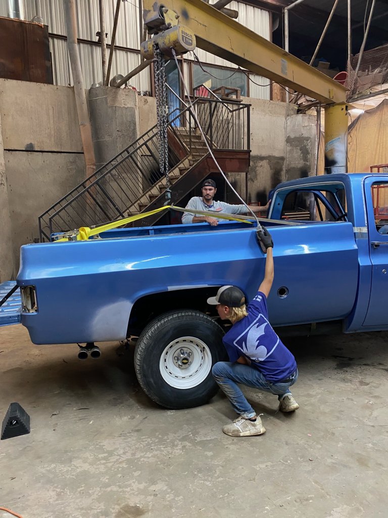

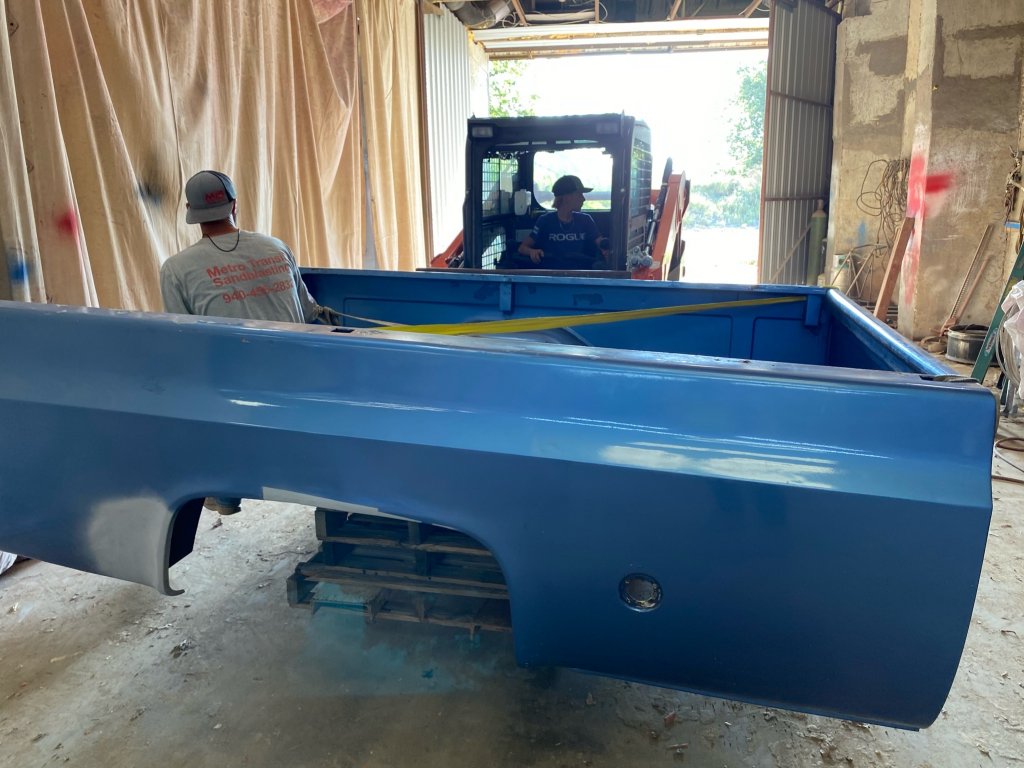

We did what @Bennyt did with the criss cross when taking the bed off but when we decided to put it back on we just did it with a few friends and I think it was easier. Have to pull it agin soon as we are about to do the western chassis 2/4 drop and can’t get to the front leaf supports to cut them off the frame. Our plan will be to just get a few guys and do the same thing.

I bought a bed lift from a body shop supply, but the brand escapes me at the moment. By the time you buy pizza and beer for three buddies twice, you'd have paid for the tool. Just saying. I found it a worthwhile investment as a one man show with aspirations lol.
