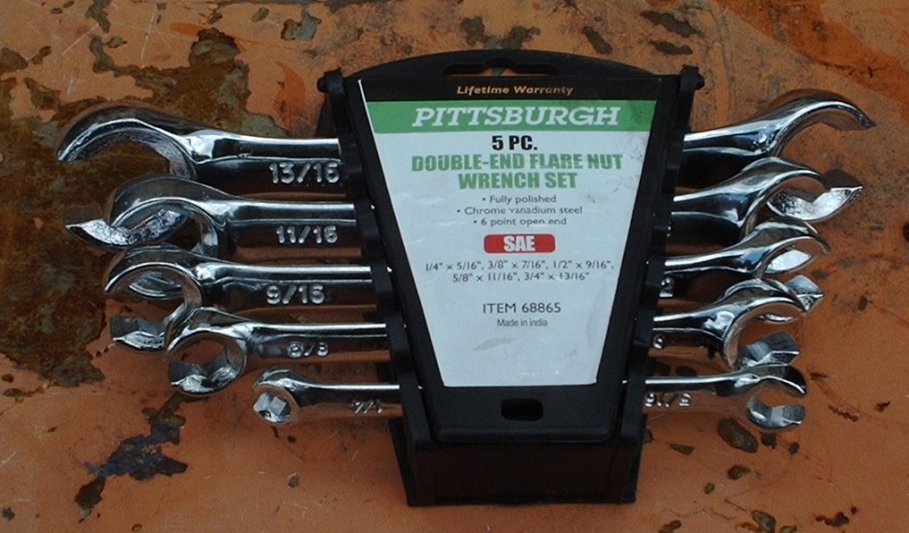

When I went to replace my front disc rubber brake hoses, I realized I only had metric flare nut wrenches in my toolbox, and needed SAE.
HF had these on sale for $9.99 and I used a 20% off coupon that made the set $7.99.
Has 1/4" through 13/16"
I wasn't too worried that they were made with inferior steel as most chinese wrenches have been up till recently, I was worried more that the tolerances wouldn't be close and they would just round off the fitting.
I was amazed how well they fit, I had one fitting that had been rounded off a tad previously, and that was a big concern.
I had no trouble getting the fitting off and back on.
I would say an excellent deal compared to what the tool trucks would charge for just one wrench.
I have found that the Pittsuburgh polished wrenches are all pretty good so far. Seem to be almost identical to the polished Craftsman wrenches too. :shrug:
