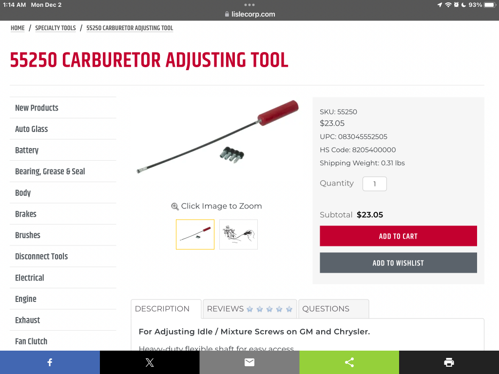

Needles ca
Lisle has them.

Original Quadrajet idle screws are usually a double-d shape, and there is a flexible carb tool that has that special end on it. When I rebuilt my Quadrajet, the kit came with new idle screws with a hex end that has a screwdriver slot in it.
Your carburetor also had factory caps or casting over the idle screws to prevent owner adjustment. In most cases the casting/cap has been drilled out, and they used to sell a special size bit to make the removal easier.
Or remove the file screws and cut a slot in them. I used a dremel tool with the thick cut off wheel, it made a slot just big enough for a pocket screwdriver.
