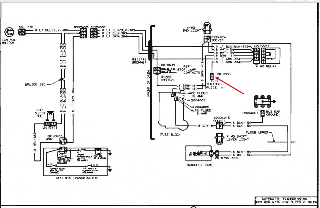

Bought an 86 K10 for my son which we are restoring. Can someone tell me what these green wires with the orange plug
are for?

Test port for the torque converter lockup in the 700R4 transmission.
See attachment- Mine is in the same spot as yours. -I'm not sure why diagram has it inside cab.
Here is a link to wiring diagrams you might find useful -LINK-
