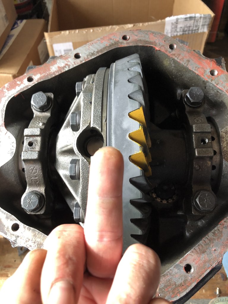

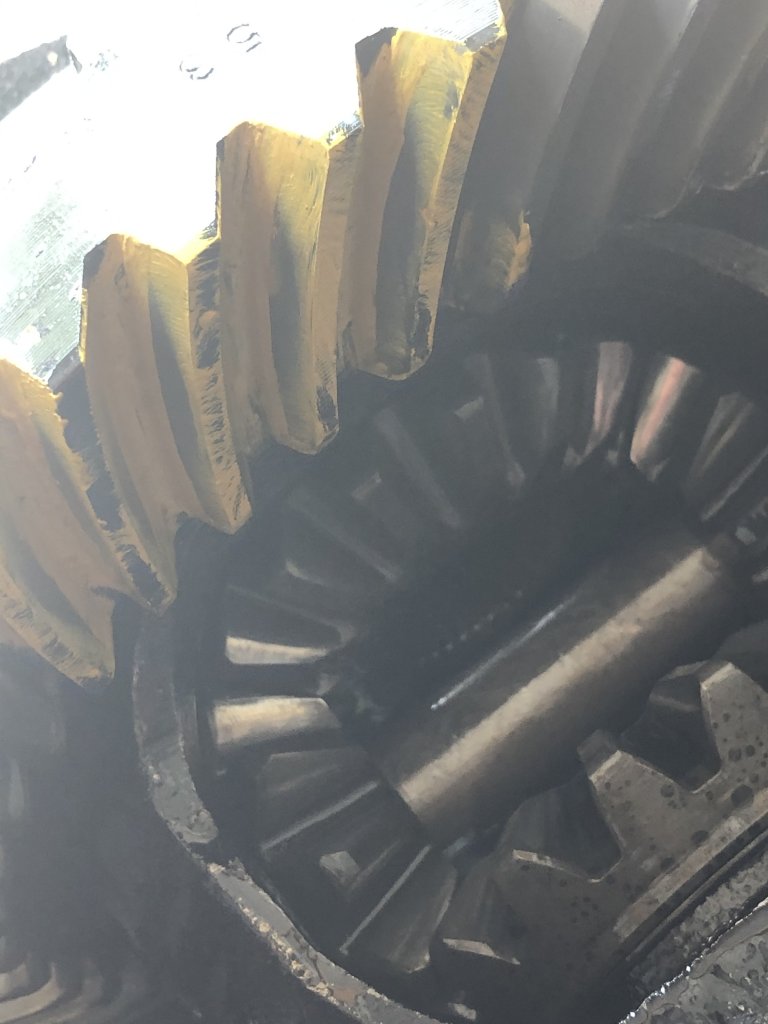

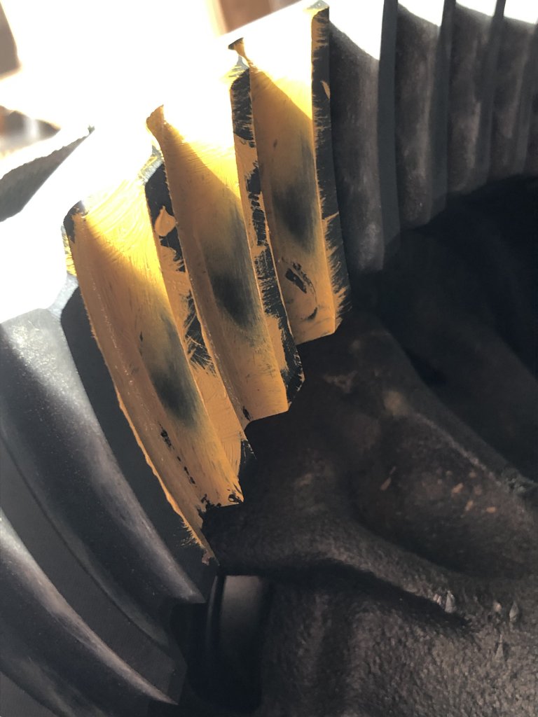

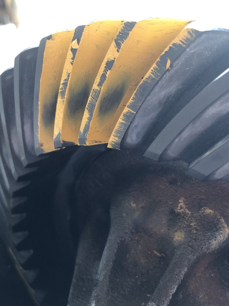

Ok.First,you can do this!I picked up a few cheap tools from H.F..Seal and race driver set,6 ton press,dial indicator and magnetic base,and caliper.
I already had very nice torque wrench.You Will need various pieces of scrap plpe,1”-2”.
Anyway-1.I would go with a No Spin locker (Detroit)in the rear.It fits inside the carrier and is a breeze to install.Plus it’s pretty much bulletproof.I’d leave the front diff open for steering,plus you’d save some money,and the 8.5 will hold up better.
2-14 bolt stock axle shafts are crazy strong.Probably not an issue with tires smaller than 38’s.However,the front axle is a different animal all together.It could be very beneficial to upgrade the shafts.Especially the stubs and hubs.Right now you’re at a 19 spline outer/stub.However,being a “unlocked”axle will help as will staying off the throttle.Plius upgrading the front shafts/hubs will be $$$.
3-I have a disc brake conversion and love it.However,more $$$.My truck stops extremely well and balanced.Upgrade you could do later…?
As far as tips and tricks,YouTube.Yukon took some time to answer a few of my questions.
I think I posted some stuff on here as well,but not much.I can give you some vendors I used,if you want.
Be patient and take your time.You got it!

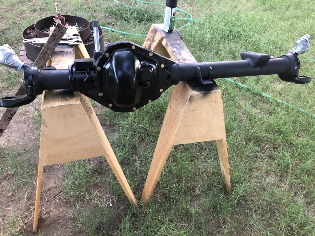

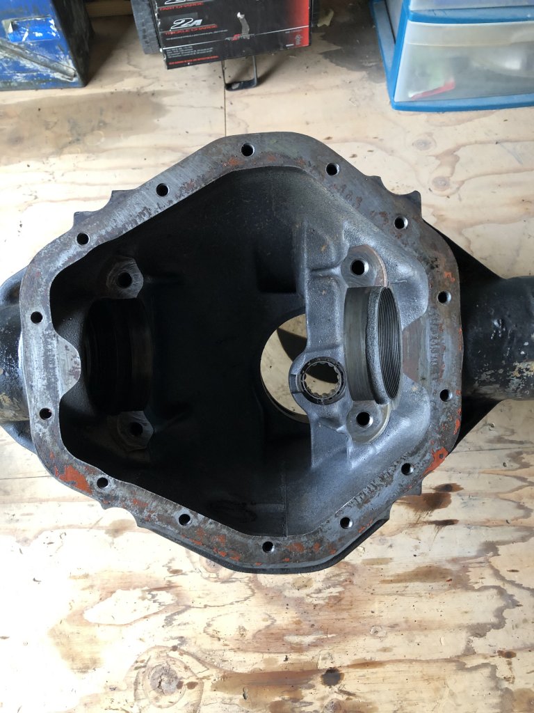

Oh,I used gas to wash my axle housings out with what’s called a wash down gun or binks gun with about a 100 psi of air to it.I don’t recommend because a lot of reasons,however,it works amazingly.Many many cans of brake cleaner and elbow grease will have the same effect.

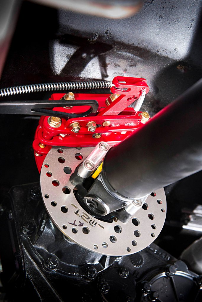

I would replace anything that looks worn.Especially fasteners that steer your truck.
And yes,you can lose your emergency brake.Some kits allow some type,or you could go with the following….if you have a NP205
