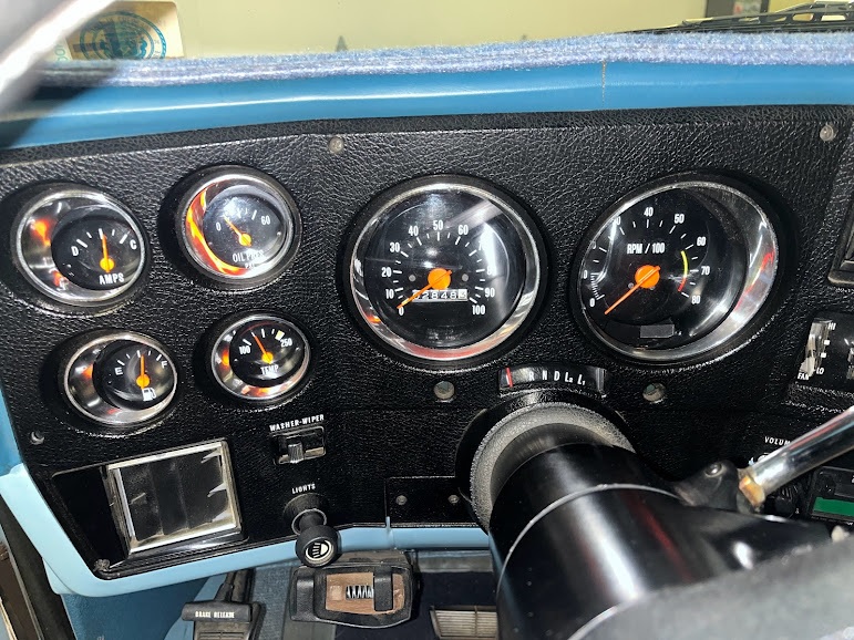

Here's mine I just finished, this past summer. I wanted the stock look. Added the 8000 RPM tach and the fuel gauge, wanted it to appear as if GM built it this way! Built the tach from scratch.
