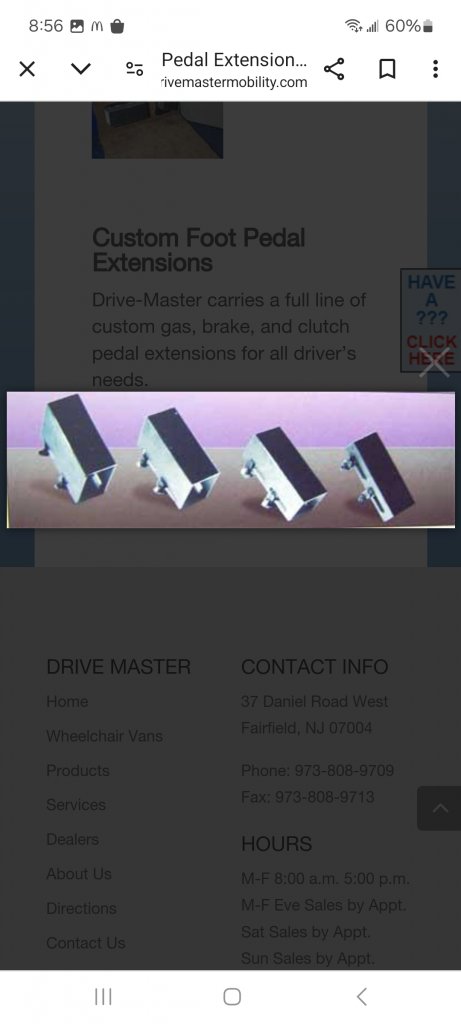

Well looking there,some one makes bolt on pedal extensions. I still think I'd try square tubing. Look at that I found some square tubing pedal blocks,in case you couldn't visualize it.
