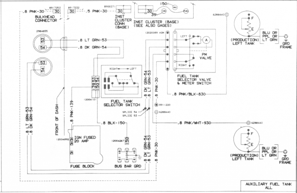

If anything lowers the flow of current the needle moves towards Full. (or 3 O'clock with no current)
so possibly a bad connection with sensing wire (pink) or bad ground. If both tanks are doing it- I would start by checking the pink wire connection at the fuel selector valve & firewall (bulkhead) & back of gauge (make sure nuts are tight)
