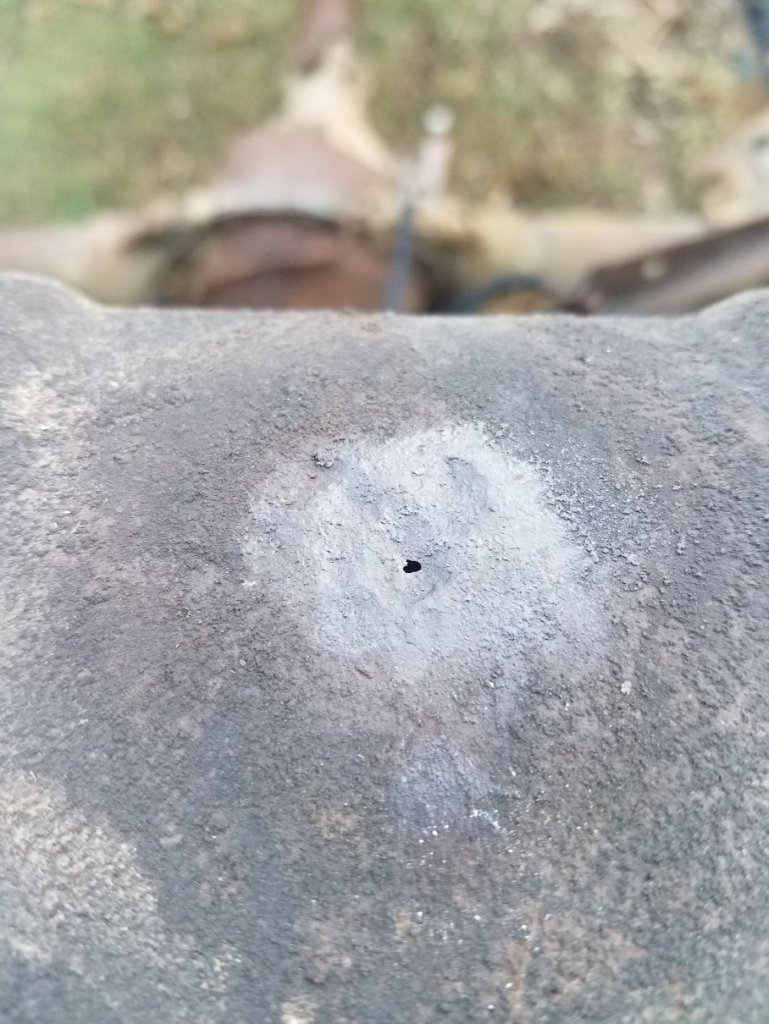

ok so i have found pin holes in top of tank. whats best way to repair JB weld. ??
i will prob get a new tank from rockauto when i can get some funds gathered up...
Tanks are cheap. Too inexpensive to bother repairing something to be replaced later.

If you have a plastic tank, those cost a lot of money. Id suggest repairing the crack since its a plastic tank. Is the crack big? Steel tanks are cheap too. a 77's filler hose and neck as has been said are different, and since the 84 has fuel doors it wont line up perfectly.
Just that one hole? A sheet metal screw,with a flat washer and a rubber washer.Put the flat washer on the screw then the rubber washer,screw it into the hole,the rubber washer will seal it.

yes sir .. i quess ill wait till i have funds to buy a new tank, i sure dont want to pull it out agian...
Thanks all......
note: plastic tank is to far gone to repair. also its a bad extra tank very cheap an installed very cheap as well..
