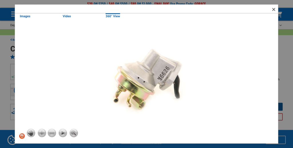

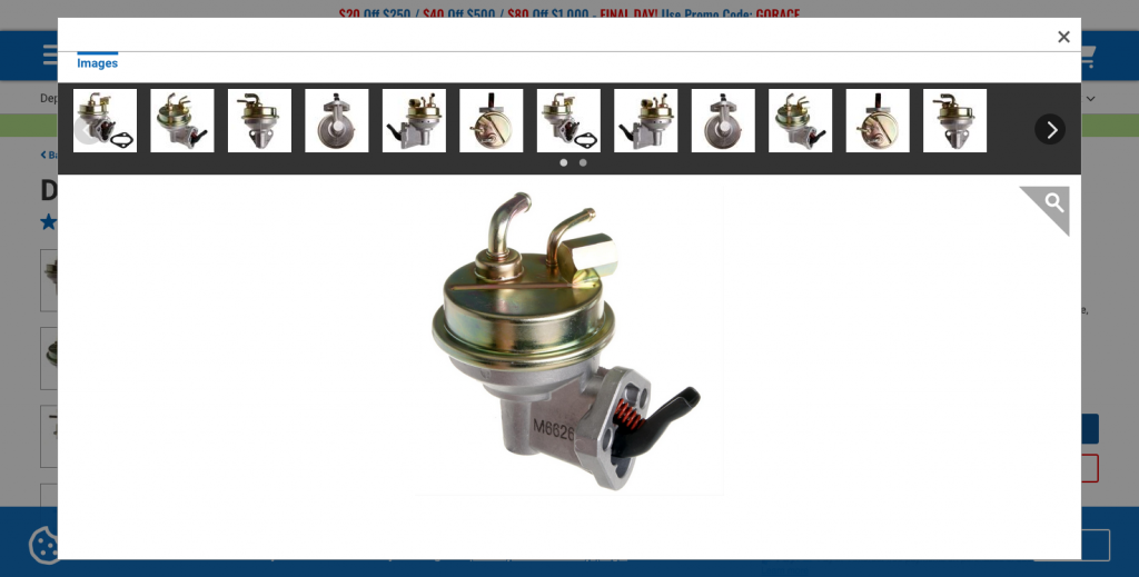

I'm not sure if this thread is still working but I thought I would give it a try. Summit lists two pumps for my 3 line stock '84 305ci with Q-jet. The first one is a Carter Muscle Car Pump M6626 for $29.99 and the second one is a Delphi pump MF002-11B1 for $16.99. A close look at the Delphi shows the same number on it, M6626, as the Carter. My concern is not price but with the specs. The Carter shows 7.5-9 psi and the Delphi just shows (stock) for the pressure. What do you folks think? Even though replacing the pump is not a difficult job, I would still rather do it just once. Thanks.
the carter pump is going to be useful where you NEED increased pressure (maybe some double pumper holleys or something?) and the accompanying flow. stock means the pump will work to stock spec which was probably somewherre between 5 and 10.
An edelbrock pump is set to output at the ideal pressure for an edelbrock carb. They dont like too much pressure
