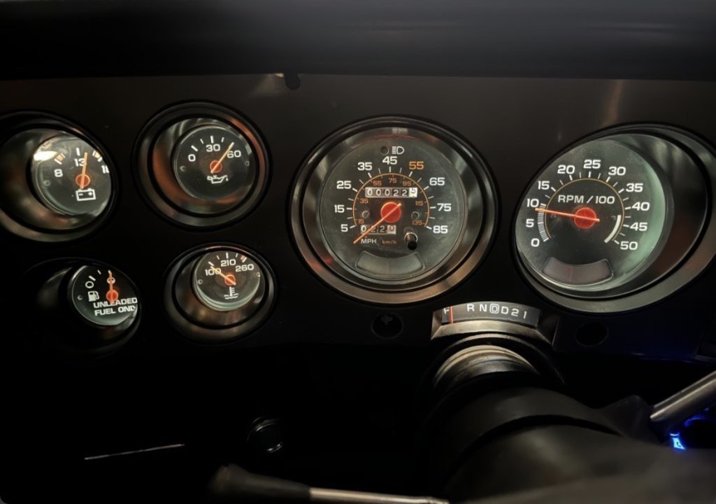

I have a '74 cluster with a factory tach in my '75, and the tach does not use any wires from the large multi-pin connector. The tach harness is a separate three wire plug, and only has power, ground and signal from distributor. I'd have to take a close look to see if the illumination bulbs are in a different spot, but they work the same as non-tach cluster.
