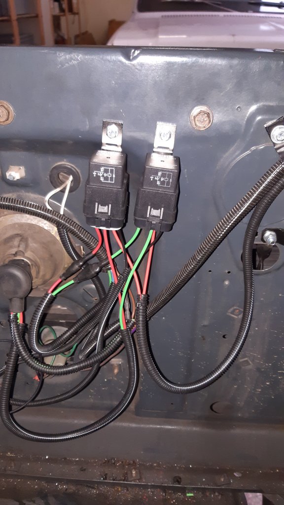

Go for a relay harness, I've put them in all my cars and trucks. Brighter headlights and less load on the old wiring and switches. You can diy this harness, it's easy and cheap. This is the setup in my k5 with painless relays.
Maybe I missed 'em, but LMC, USA1, etc don't have any for the 83 and later year models.
