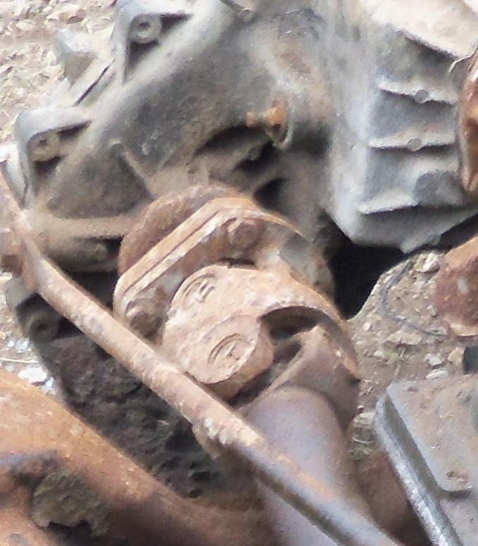

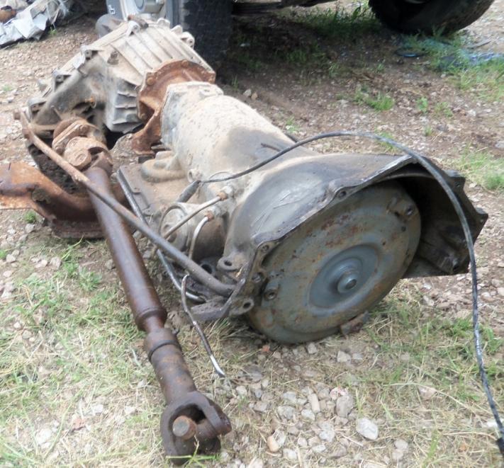

Yes. I know that the bolts should not thread into the holes on the flange on the driveshaft. I want bolts that will thread into the flange on the T/C. I believe the T/C is a NP208. I'm considering just using 3/8"-16 bolts with nuts on the ends at this point. Maybe they aren't supposed to thread there either?
47,128
9,299
If yours is an 87 V10, I have this from an 87 V10 laying in my backyard. 700r4/NP208. I bet I can find out for sure in daylight.

I used bolts and nuts on mine so i know for a fact they are tight.
Just saw your post. I think this is what I'm going to do. I don't see how there can exist a bolt that will actually thread into this thing. There isn't anything I can get my hands on between a 3/8" and M10.
