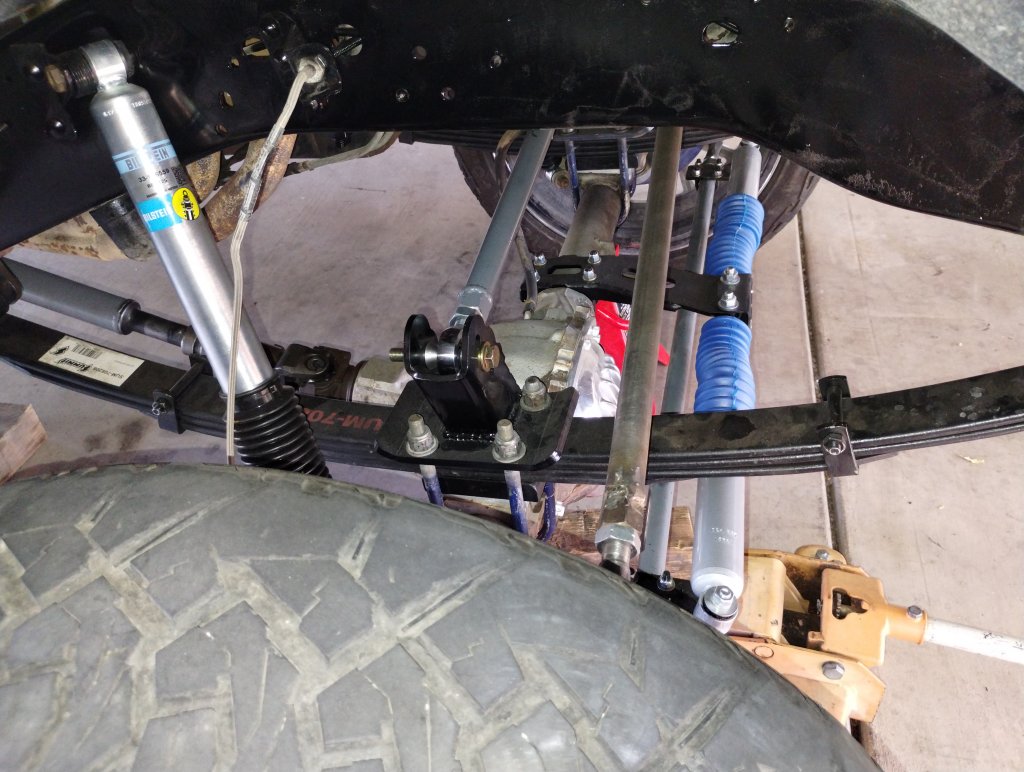

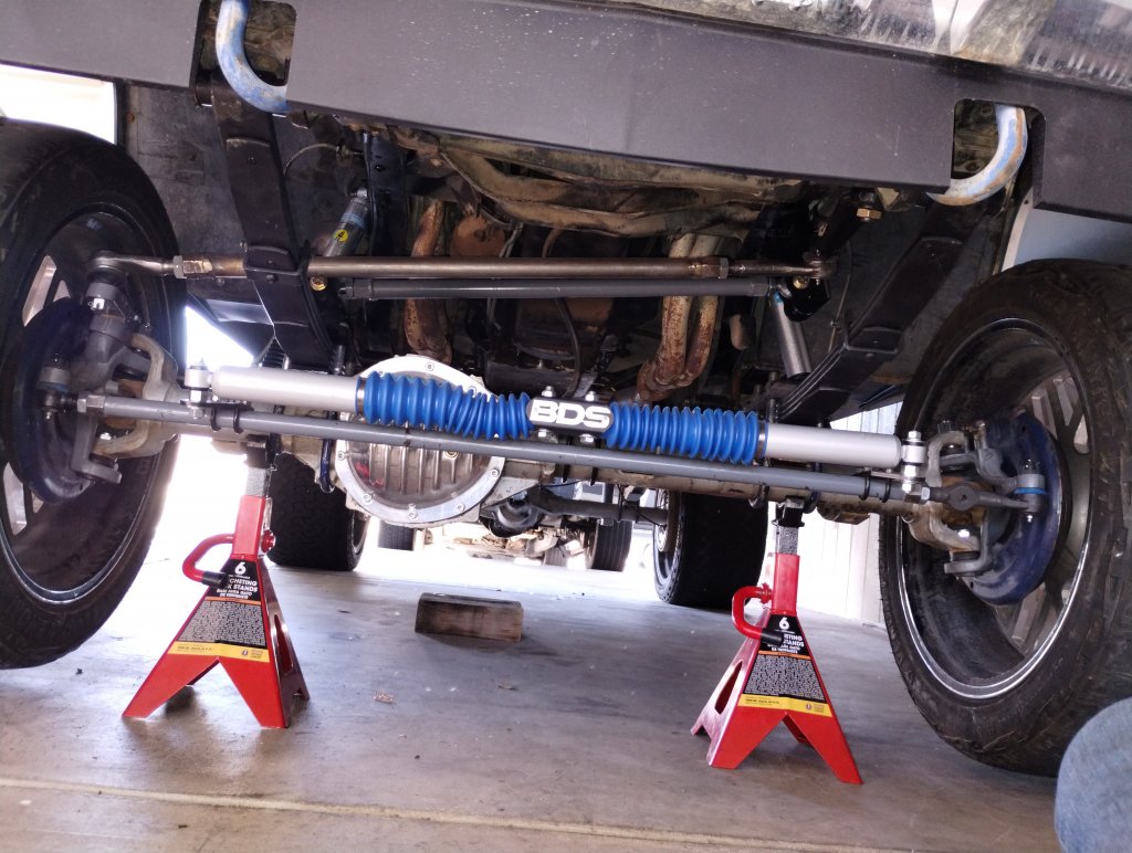

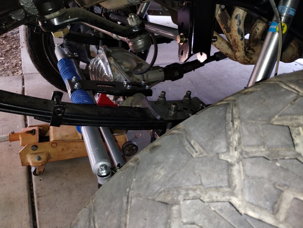

I know this is an old tread, but here goes. I had the same issue with my 86 k10. For years, that axle issue bothered the f*%k out of me. Nothing I ever thought of worked, until now. So I decided to bite the bullet, and spend the mula, and do a crossover steering setup on my rig. I also added a panhard/trackbar, from the frame to the passenger side spring perch. I loosened all the spring bushings, centered the axle using the panhhard bar(its adjustable, just like the tie rod). Tightened down everything, and wohalla! Axle is centered on the frame, The panhard bar/track bar keeps it there.
If the track bar is pulling against where the leaf springs are naturally locating the axle, it may cause binding as the suspension cycles. The axle should stay centered by the springs. The track bar may center the axle at ride height, but it’s pulling against the spring bushings as the suspension compresses or droops out.
If your truck is set up to drive on relatively flat surfaces, that probably won’t matter. If you have a decent amount of wheel travel that may get interesting geometry-wise.
Nevermind, I see your wheel setup. The articulation and off-road related comments are irrelevant to your truck.
