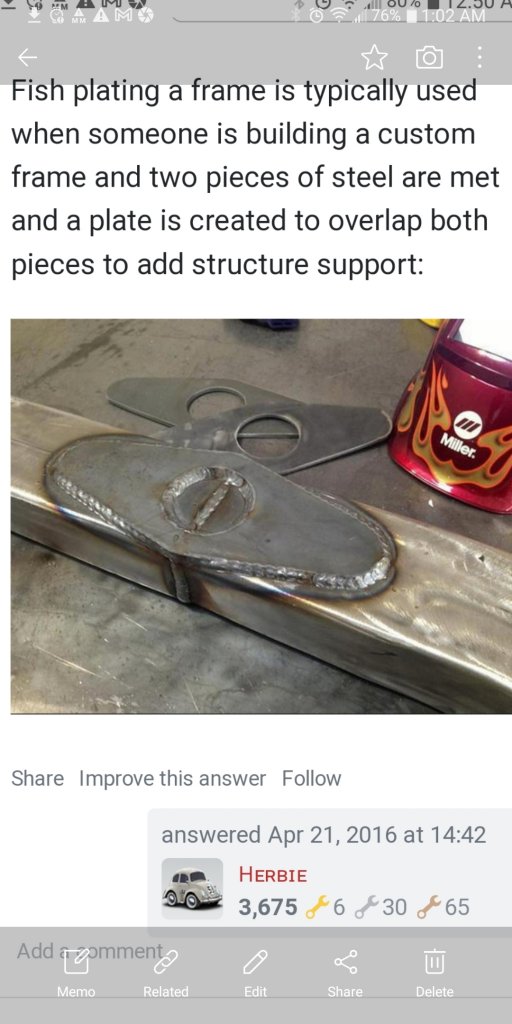

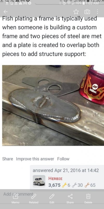

People , cut weld and gusset truck frames daily. Whether its for a shorter wheelbase for wheeling, a longer wheelbase for something custom, or shortening a longbed into a shortbed. Old school was weld a diamond shape gusset over the repaired area. Not sure what current best gusset arrangement is,but if the surrounding metal is still structurally sound you will not have a problem.
