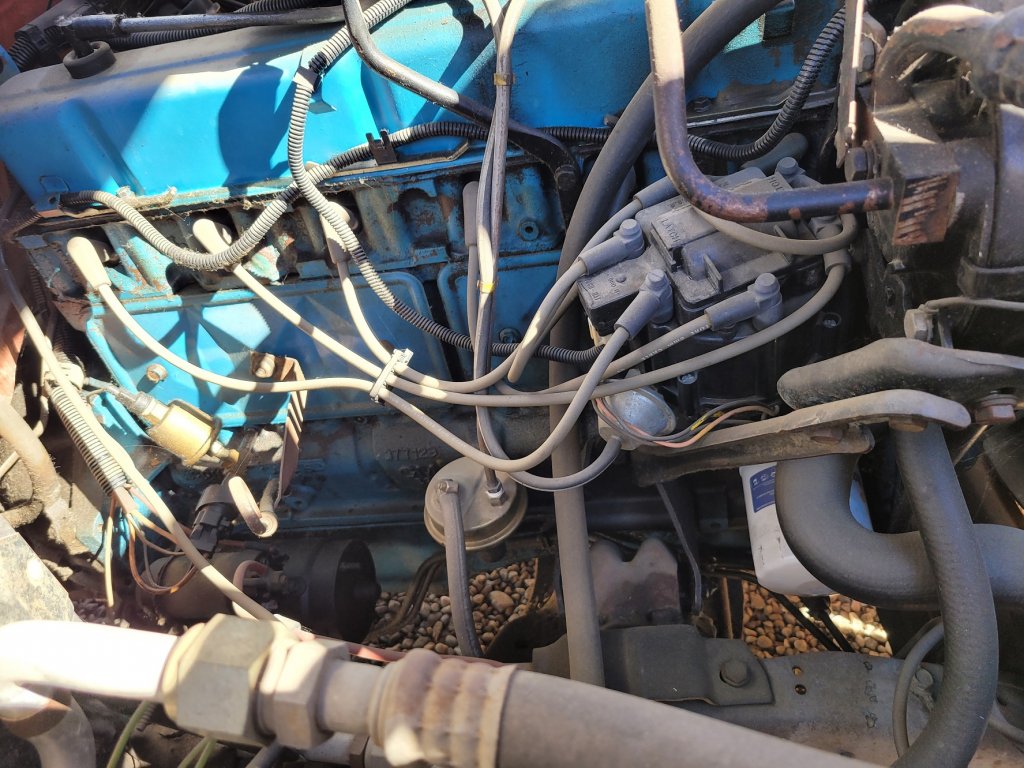

Guys, I found a free motor and looking for identification on it, any ideas what I got? I'm thinking it's a 250 ci it's said to of come out of an 81' or 82 chevy c10.... any help would be appreciated....

292’s also have the fuel pump behind the motor mount, 250’s (and 230, 194)have it in front of the motor mount.

I googled the casting number 473483, it's a 1975-79 250ci.
