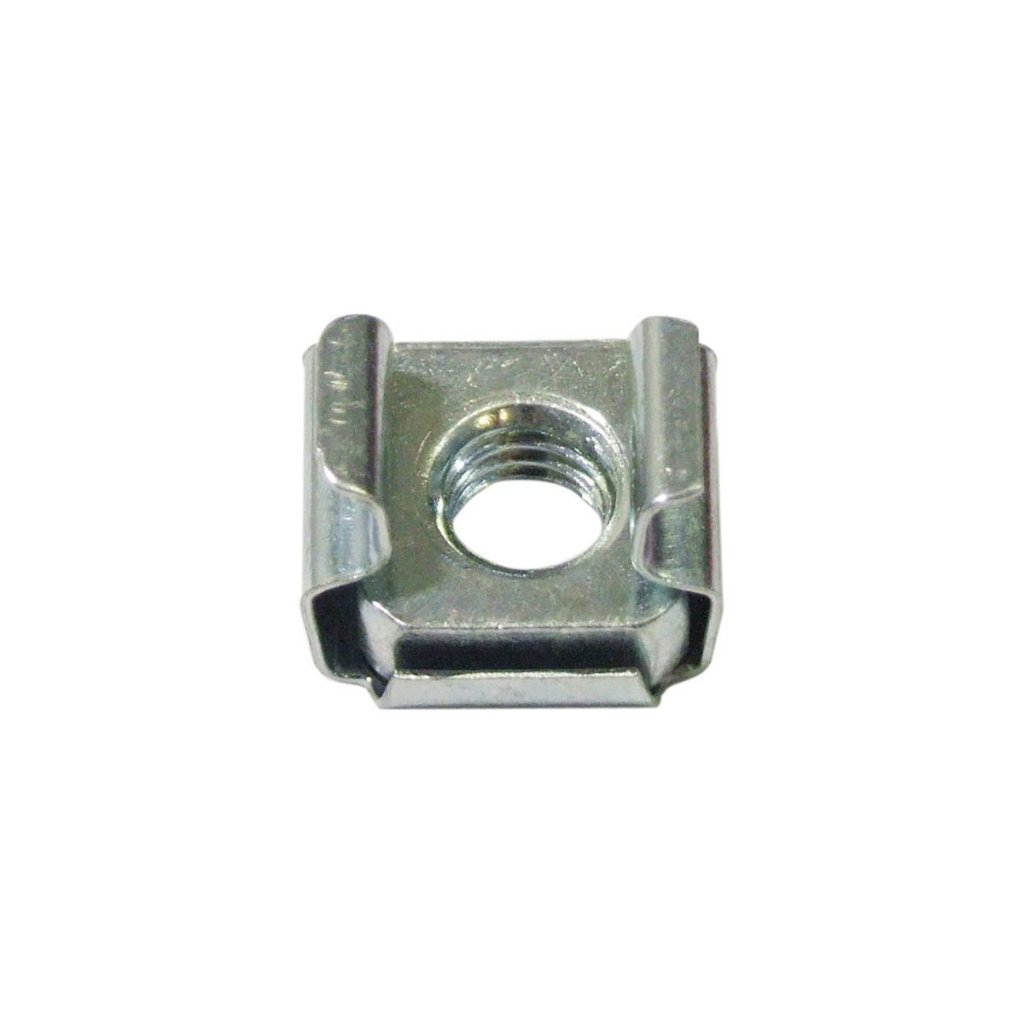

We use those in audio/video racks, they are called captive nuts. They have several types and shapes of retainer to hold them in place.

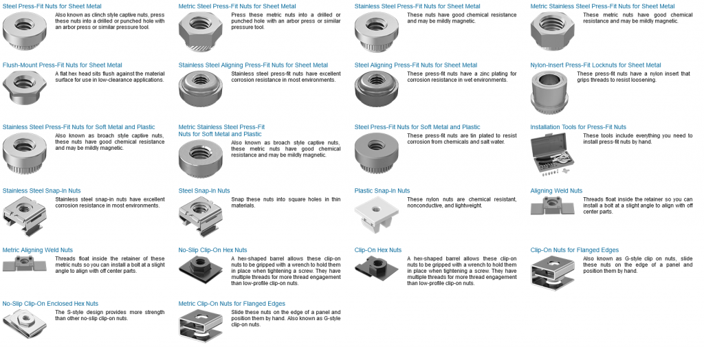

Here is a better pic of the different types of clip, captive nuts.
