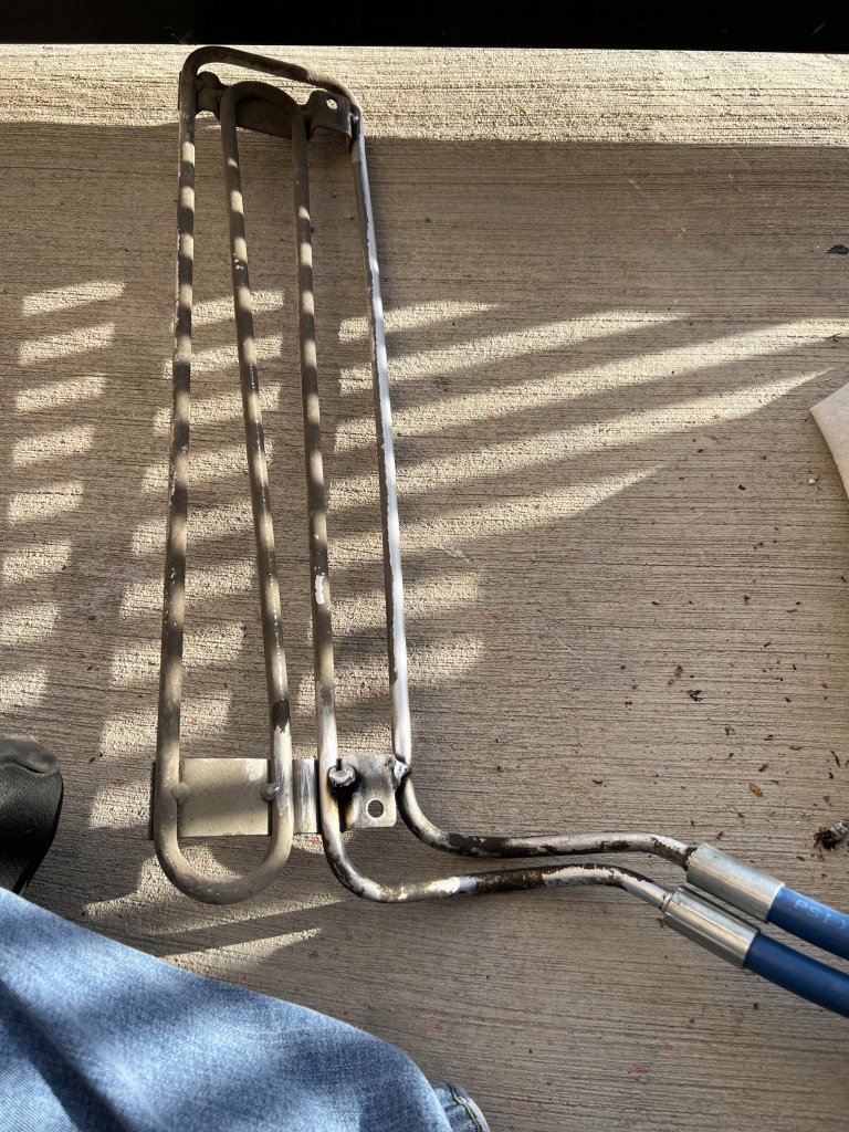

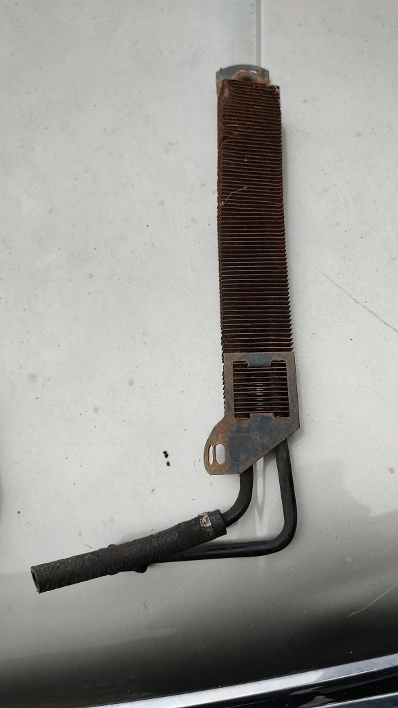

There is what appears to be a power steering fluid cooler/coil mounted underneath the radiator (See photos).
Does not have hydroboost. I can't find any diagrams or anything similar to this anywhere online. The hoses connecting it are crimped/banjo'd onto the cooler, so it's all one piece. Hose fittings are starting to leak so wanted to replace or repair. Was this a factory option?
Thinking I could take it to Napa and have them replace the soft lines and fittings.

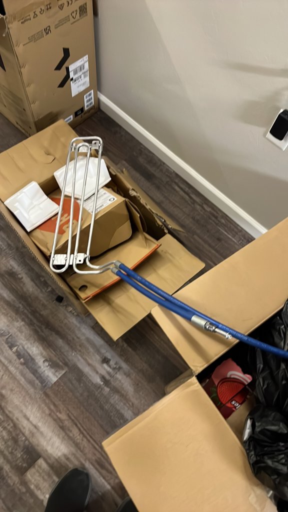

Well, I took mine off, cut The crimps off on each side, broke them apart pulled the hose off grinded down the tack weld so that the ends could be separated far enough apart to be put in a hose crimp machine had my local hydraulic hose shop put new crimps on and new hoses (the blue hose is MSHA certified and that’s what my local shop had for chemical resistant hose) Had a welder at my work Tack them back in place note it is aluminum, so make sure you can have someone weld aluminum or braise it without popping a hole through the line…… But if that is not an option for you, you can cut the crimps off with a small Dremel make sure to not go threw the hose. They are pretty fragile so you do not need to worry about cutting 100% of the crimps you can spread it apart very easily with a flat tip screwdriver. There will be two flares on each line the in and the out and you could clamp a hose onto it with a hose clamp it won’t look as clean, but it should function just fine

The OBS trucks use this kind of power steering cooler too, but there is a better option. The later ones with HD towing package, and the big blocks and all 3500s got a finned version. I thought I had a pic of it, but I'll have to get it tomorrow (part is out at the shop building 10 miles away).

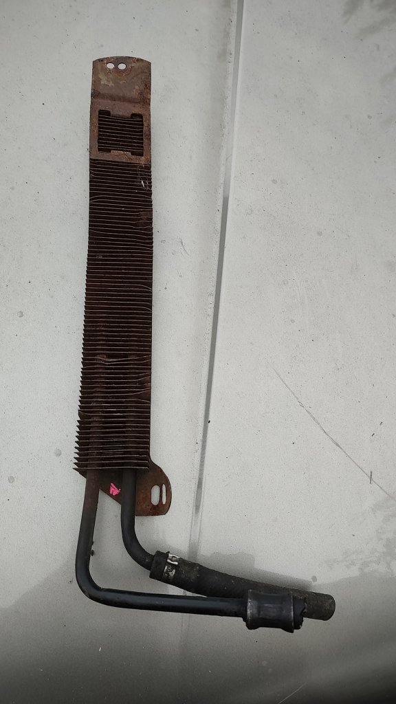

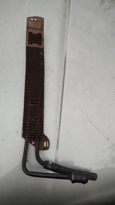

This is the style I am talking about. I got this off an OBS dually, but my Crew cab has one as well. It's kinda tucked under the edge of the grille opening so difficult to get a picture of it installed.
These are apparently unpainted from the factory. Rust on this looks like surface rust, I got it to put on my burb.
