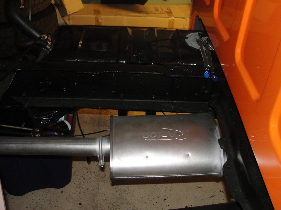

raptor's
Here's a pic of the raptor muffler
