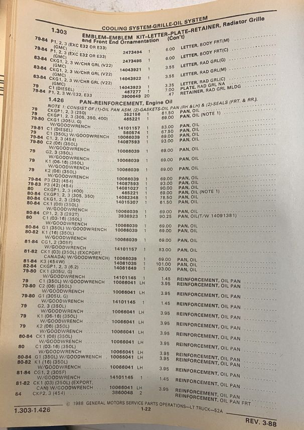

I think I read on here recently that there are 4 quart and 5 quart oil pans for small blocks in trucks?
