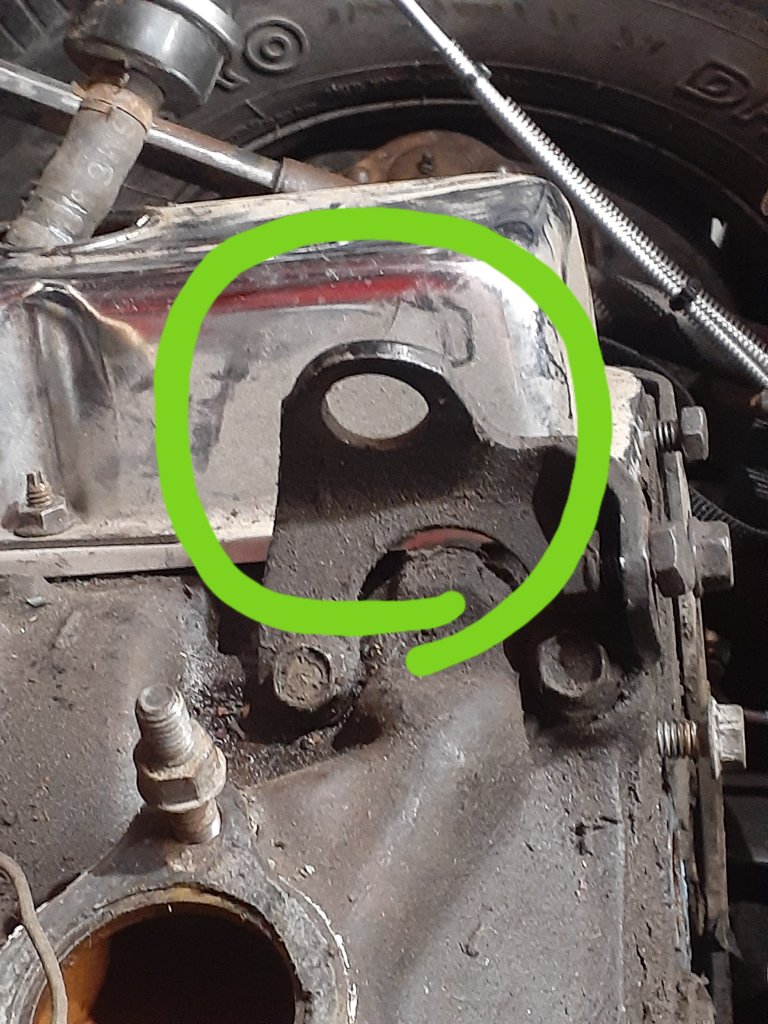

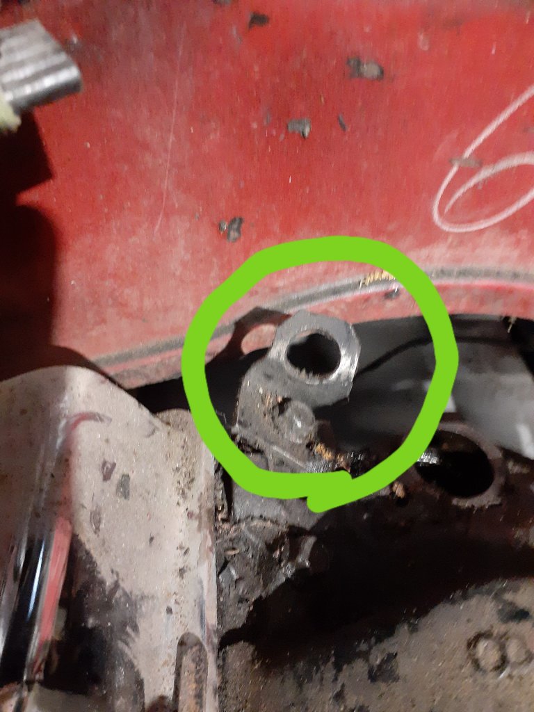

Are these engine lift points? First pic is the back right second is the front left.

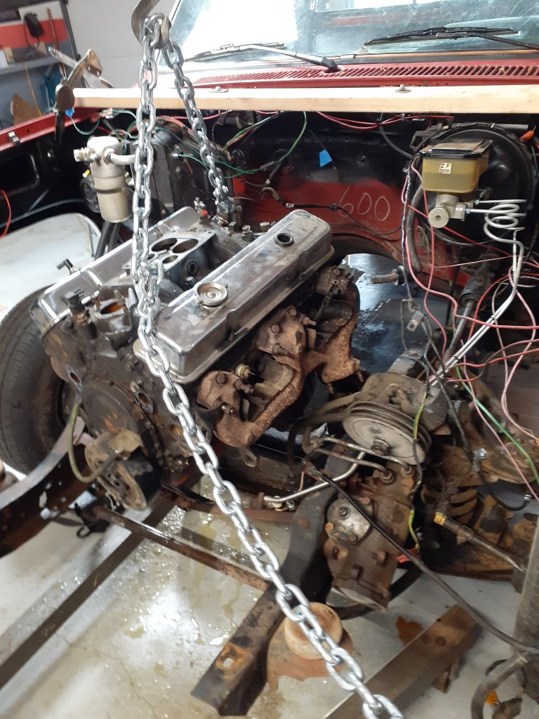

milk shake in the pan needs context. was it condensation? not worry. was it after running operating temp? yikesTran is out does that make using a chain across diagonally acceptable. Hood is off also. Thing is I need to remove it tomorrow. I think motor is junk had milk shake in the pan.

Love the one I got. The screws are kept on the plate and you pull out what you need. Solid and secure to the block.Those are perfectly fine to lift an engine, that's all I've used. You'll be okay remove or stab the engine with those and a chain. I have heard good things using the intake plates, just can't bring myself to use one
