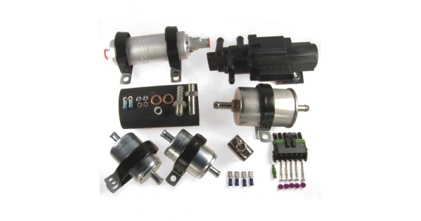

Ive installed a fitech 600 power adder about 5 years ago and have had multiple leaks from hose failure lately. Ive got a functional dual tank setup using an 86 selector valve (truck is an 84) and all rubber hose at this point.
Is there a better solution using steel for plumbing the majority of the supply and return lines? Id also love to know of a way to find a selector valve for the tank that doesnt require hose barb connections. Ive got to replace every inch of the current rubber hose and just hope there is a more lasting solution with the crap ethanol fuel we have to run these days.
