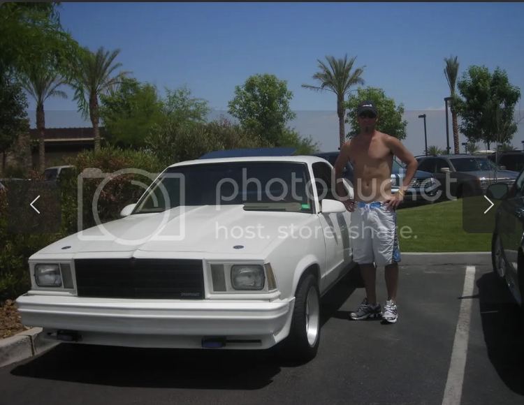

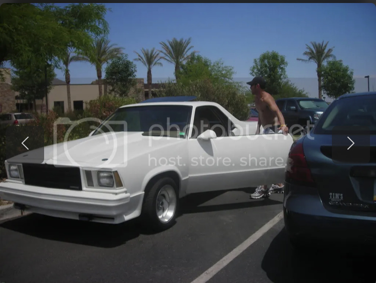

Aaron, from one woodworker to another, it all in the preparation! You already know this. There is a chemical bond and a mechanical bond. Prep per manufacture directions, DO NOT DEVIATE!
Honestly, sand by hand. With your woodwork experience you will be able to feel the difference in what needs to be addressed! Sanding blocks are your friend!
After applying, it’s all about how much work you want to put in! Do you mind your paint job looking like a new Mercedes/orange peel or do you want it mirror flat?
Up to you! Do you want to raise the grain or do you want to sand dry?

70SBUDGET Is your el camino GM artic white? looks nice!​

DanMcG, I’ll have to ask dad. It was a single stage ppg or DuPont. That does sound familiar. Thank you. I still have wet sanding nightmares!
