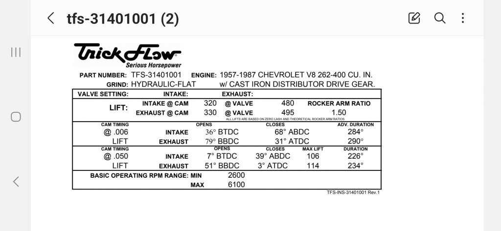

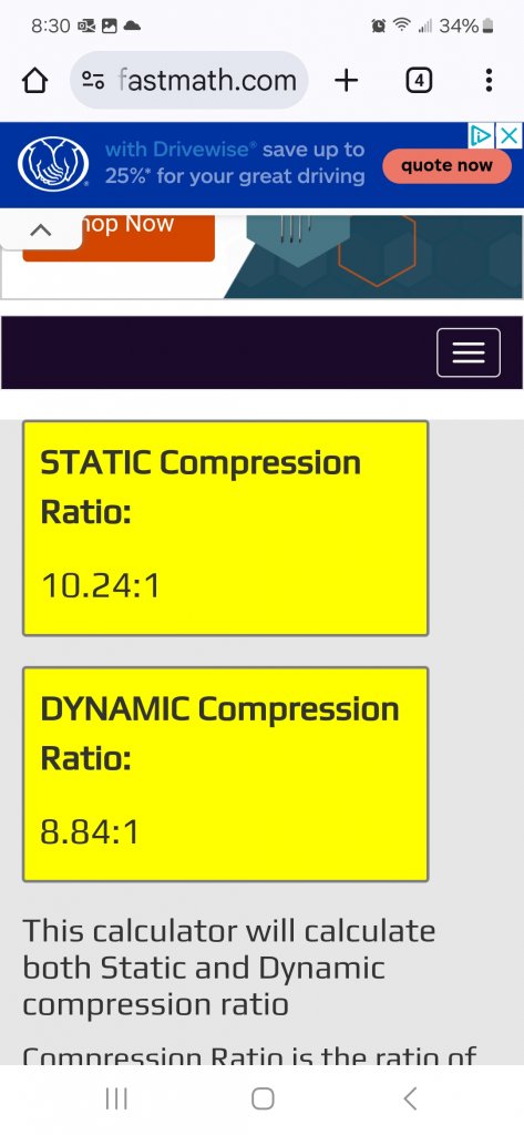

I'm a little concerned my dynamic compression will be too high. My calculated DCR is 8.8:1. Is this too high for pumped gas?
Here is my specs:
Bore 4.03
Stroker 3.75
Deck clearance 0.015
Gasket 4.06 x 0.027
Piston +12 dish
383
64 cc trick flow 23 heads
See attached for cam card.
I considered thickening the gasket but then I might risk the squish range. Can't do any machining but worst case could swap a cam at this point. I'll be running the holley sniper 2 btw.
