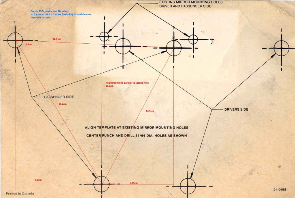

I'm also trying to attach the Dumbo mirrors to my 1977 Big10 doors. Just received the mirrors and all the hardware for mounting them from LMC. Was hoping to find a template in a PDF form, so I could get exact measurements when I print out the PDF. Was confused when I noticed the brackets are different sizes and don't know where to mount them inside the door without a location to drill mounting holes. Can PDF documents be attached for download here, or is it just pics? If I find anything new, I'll be sure to add it to this thread. Thanks to all those helping out here.

There may be a pdf available in the Library section here, but I don't remember if any of the manuals posted are assembly manuals.

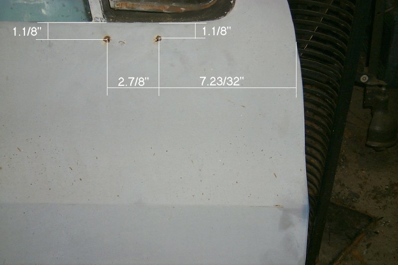

Several years ago, I posted pictures of the factory hole locations, along with measurements. I'll see if I can find those again.

Oh... looks like it was this thread I posted them in, lol. Those are the best I can do.

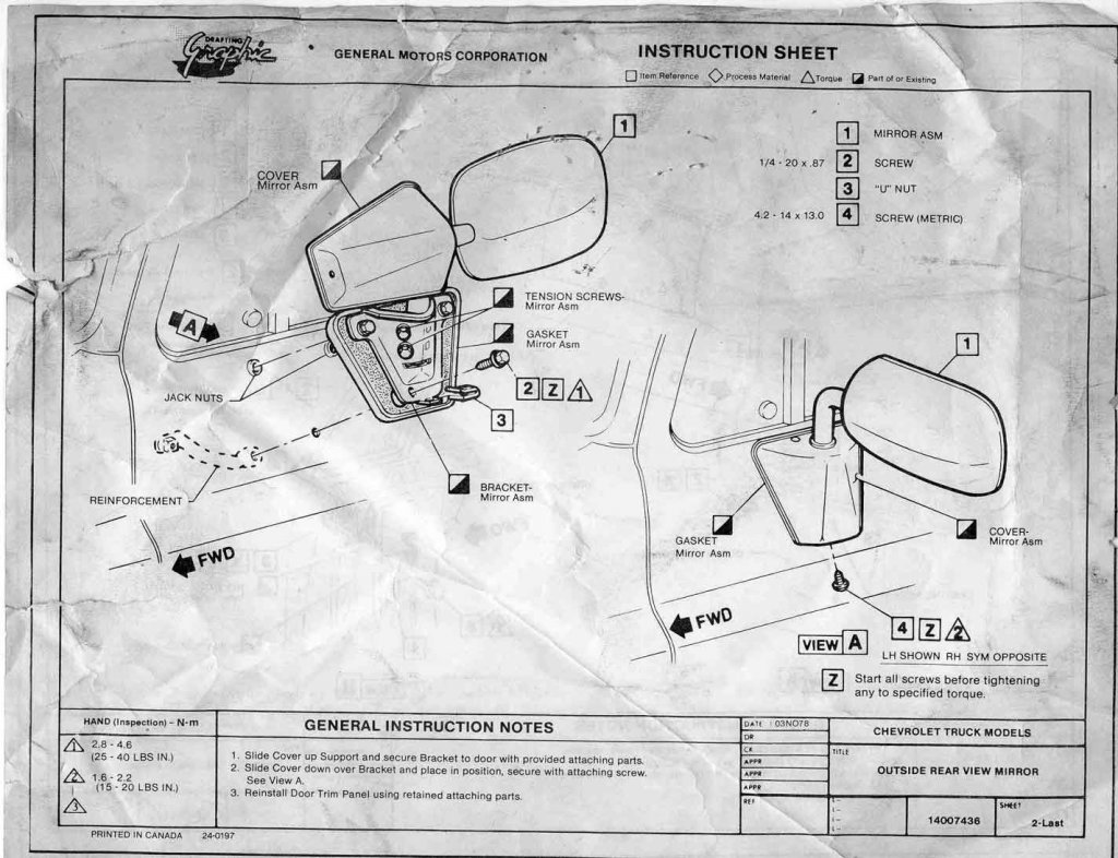

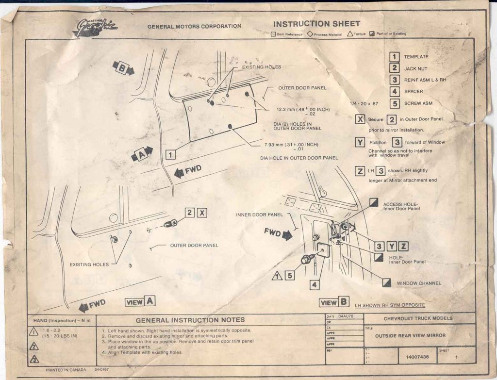

I found this picture of the OEM instructions , unfortunately they were already cropped. I found another thread on here where I described the location.
The center of the mount is about 1/2 way between the vertical post and the wing window handle. The door has a flat area to mount the mirror. Make sure the stainless cover is above the start of the curve in the body.
Make sure you get the barrel nuts for the top holes and use the OEM brackets. The bottom bolt attaches to the bracket.

On factory mirrors there are two bolts that clamp the mirror head (#8) in the diagram. I put on LMC mirrors on my truck and it uses Phillips head screws. Mine keep moving, so I’m going to put the LMC mirror heads back on my factory bases and hopefully that will stop.
