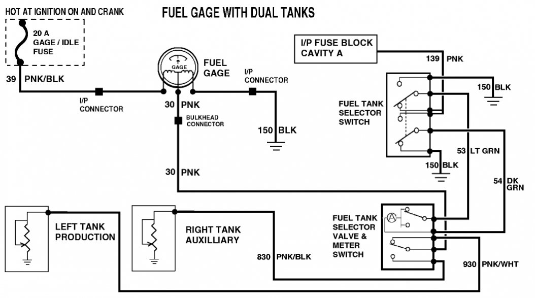

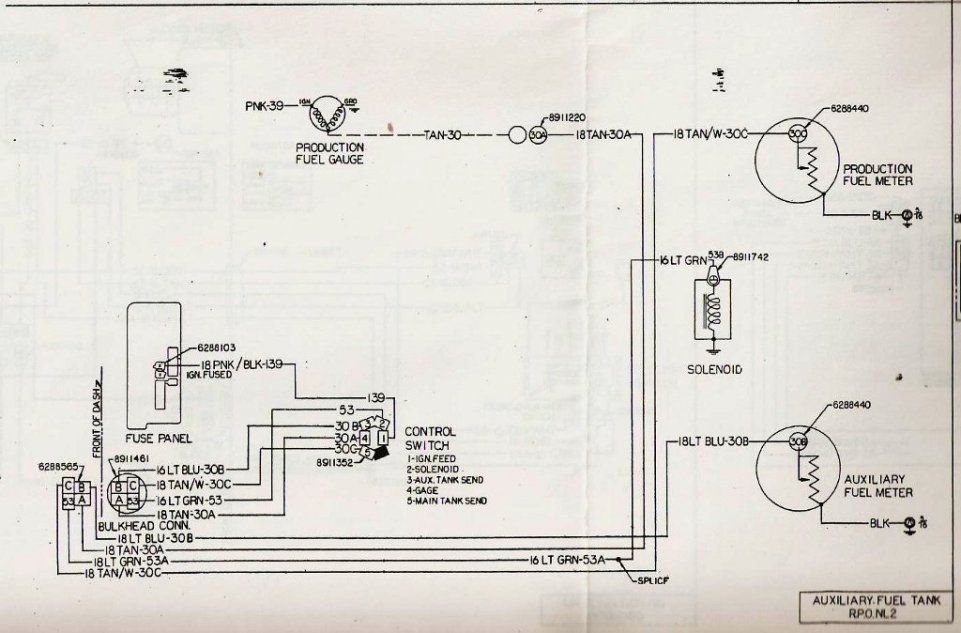

I think it was a single wire controlling a solenoid actuated valve (NO to the factory tanks by the spring - and held open to the auxiliary tank by powering the solenoid coil) from the earliest designs up until around 1981?
From then until the advent of TBI systems it was a 5 wire control circuit that operated the Pollak valve.
After 1987, when TBI was the only game in town, the control circuit was again changed back to a latching type. I don't know why - maybe because of the increased fuel pressure and the pumps being moved to suction side of the valves there was a concern that the pump pressure could inadvertanly shuttle a motorized valve?
Schematics for the two designs:
