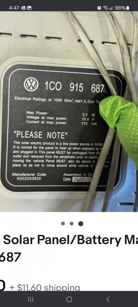

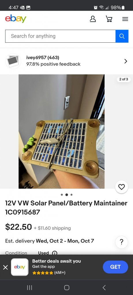

Maybe make your life easy. New Volkswagons used to ship with a solar battery maintainer installed,so dealers never had a dead car on the lot. Dealers removed them before sales. They suction cupped to a window and plugged into a cigarette lighter,dealer techs used to peddle them on ebay for 10.00 I bought one there but it's been years. Maybe still a thing,maybe not but easy to check. Just looked on ebay not cheap anymore I snapped you 2 screenshot 1 so you'd have specs.

^Great piece of trivia or memorabilia but there’s so much out there for solar maintainers compared to whenever VW did that it would imo make sense to use some “new” solar.

Has Solar really changed that much since the TDI golfs?
Depends what “that much” means. Efficiency, yeah in the last 30 years, typical efficiency has about doubled and solar panels degrade with time/use as well. So idk where that leaves the 15-25 year old VW units, but that’s not the issue I was referring to. I meant “new” as in not old/used/unknown condition for $50 from some schmuck off of Fleabay.
They were actually decent units at 10W. But again, it’s not like finding a solar charger is difficult or rare. They are more common and numerous now than in the past.
