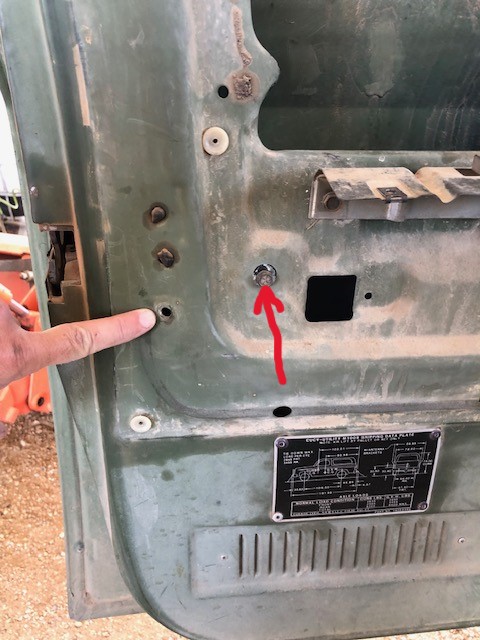

Two holes that can be mixed up. That what happens to me. I used the hole to the left, which positioned the glass guide away from the glass and therefore didn't hold the glass in the slot. Now with the bolt in the right hole, everything works perfect. Thanks a lot again. You made my day!
