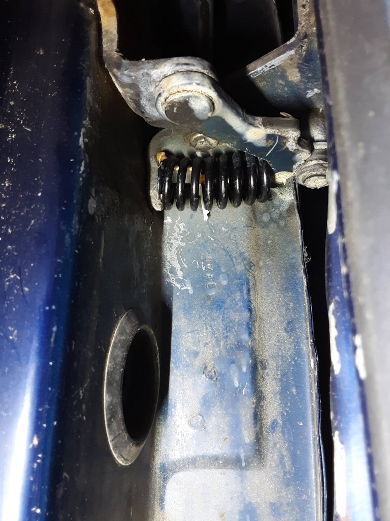

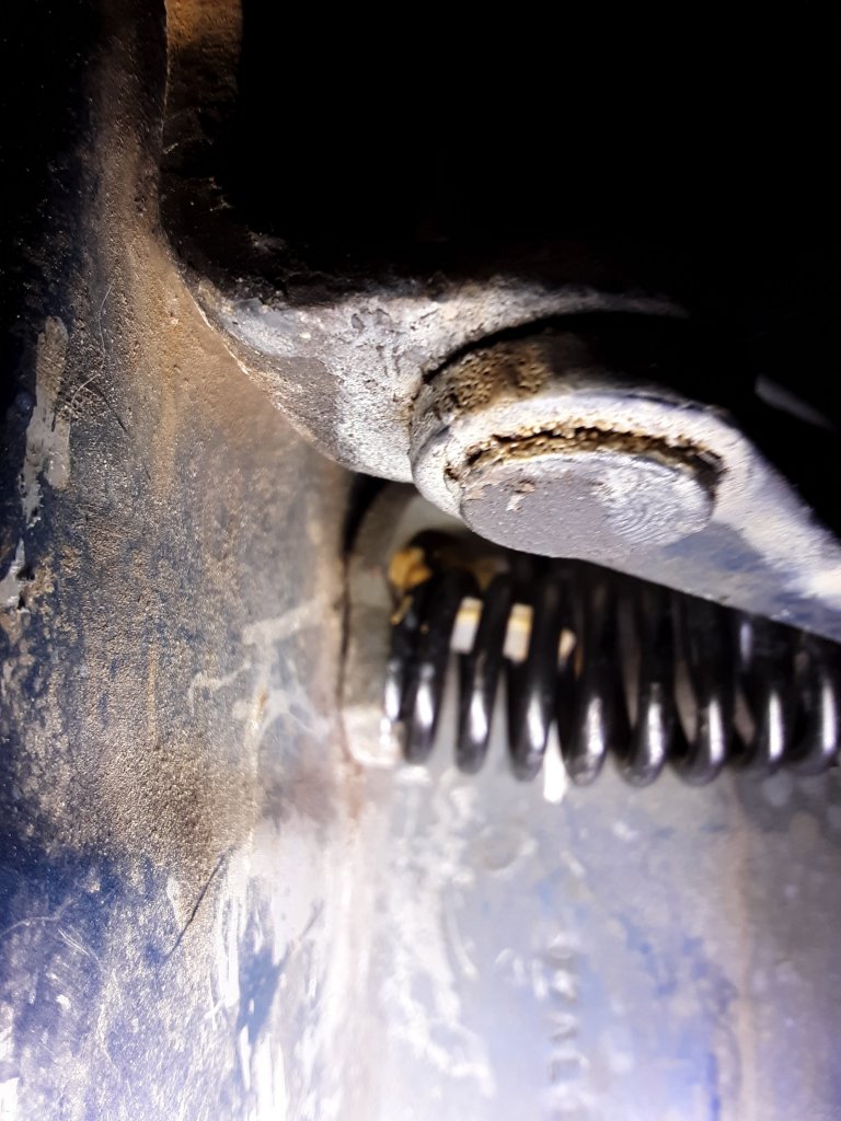

I do NOT recommend how I replaced my door spring.
(1) I compressed the new spring as much as possible in a vice.
(2) Used 2 or 3 decent size zip ties to keep it compressed.
(3) Set the spring into the hinge and
(4) Used a propane torch to melt the zip tie.
I used the materials on hand, the door on the truck and I have life insurance.

Maybe @Rickf s idea using a big a$$ hose clamp instead of zip ties.

Oh ye of little faith, remnants of melted zip ties.
AWESOME! That little coil could definitely do some damage if it compromised the zip ties.
