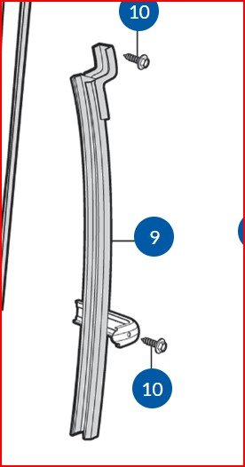

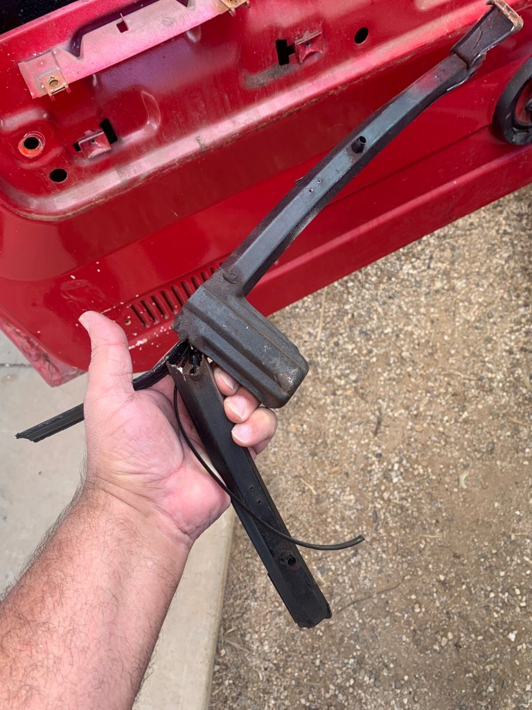

I recently broke the Glass Channel on the drivers side window of my 74 K5. LMC does not stock these and I cannot seem to locate a vendor. Would anyone know where to get a replacement for this particular part? I do see lots of pics on the net but these are all for trucks. The 74 has a full removable top making the door different.
Any help would be greatly appreciated!

Use a wire wheel to clean up the broken area and braze it. It'll be good as new.

Snoots your idea of brazing was close to what I did. I soaked my parts and deleted all rust and then used metal rods to stablize a nice mixture of JB Weld. I dont have brazing skills so this is what I could do. Its strong as hell now and I painted all of it to keep the rust out. I then picked up Window Glass Flocked Channel rubber off Amazon:
I used a ruber adhesive and re assembled. Dang thing rolls up and down slicker than snot now.
Thanks everyone for your input. It is very appreciated.
