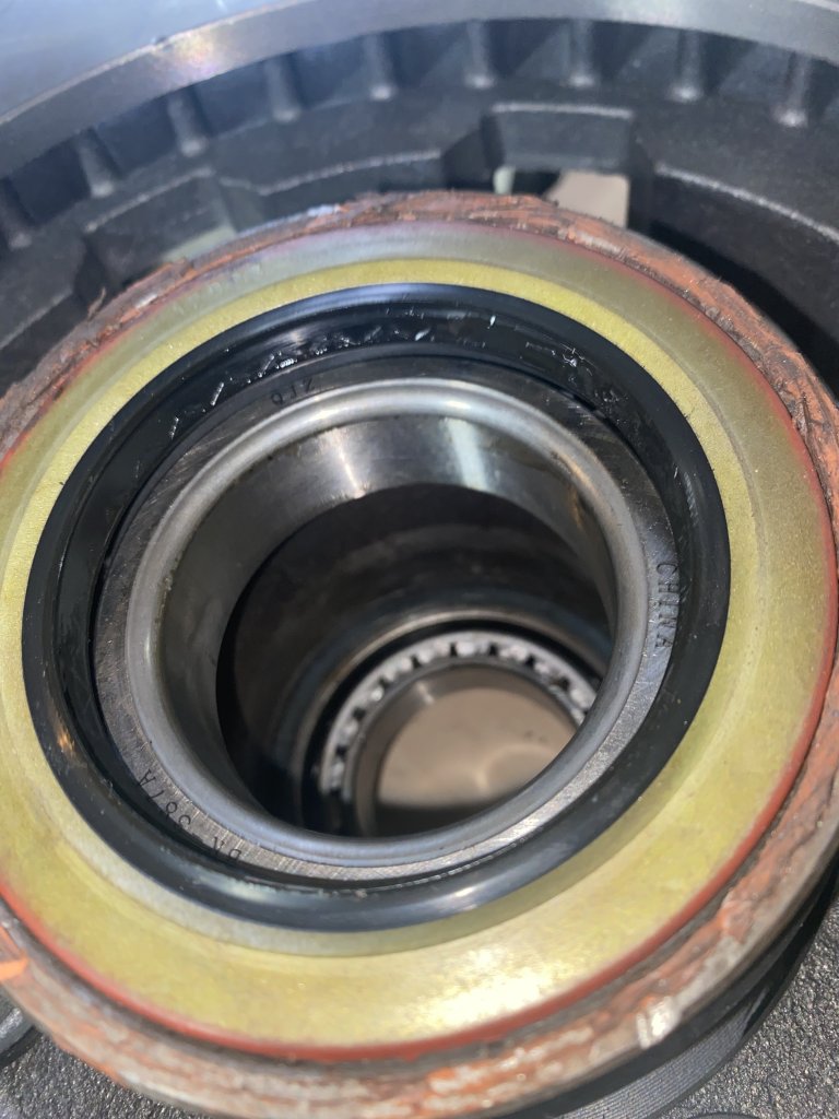

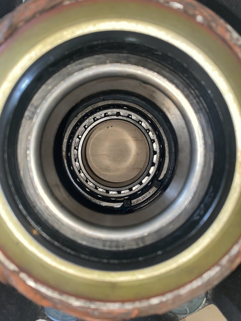

So kind of a weird issue here, I didn’t see anything about this in any other threads. Doing the disc brake conversion and everything went together great until I went to put the hubs/rotors back on the axle. Both sides need to go on like a 1/4-1/2 inch farther. All the bearings and races in the hub seem to be seated correctly. Had each one on and off a few times and I’m totally stumped, not sure if anyone has ever had this issue or any suggestions. Below is a picture of how far I could get the driver side hub/rotor on. And a couple of the best pictures of inside the hubs I could get if that helps at all. Thanks!

Did you ever check to see if your bearings fit the spindle correctly, before you put them in the hub? If you're positive the races are seated then I would think wrong bearings.

They looked identical when I had them side by side, but I never actually put the new ones on the spindle so I guess that’s possible. Might just have to take everything apart again

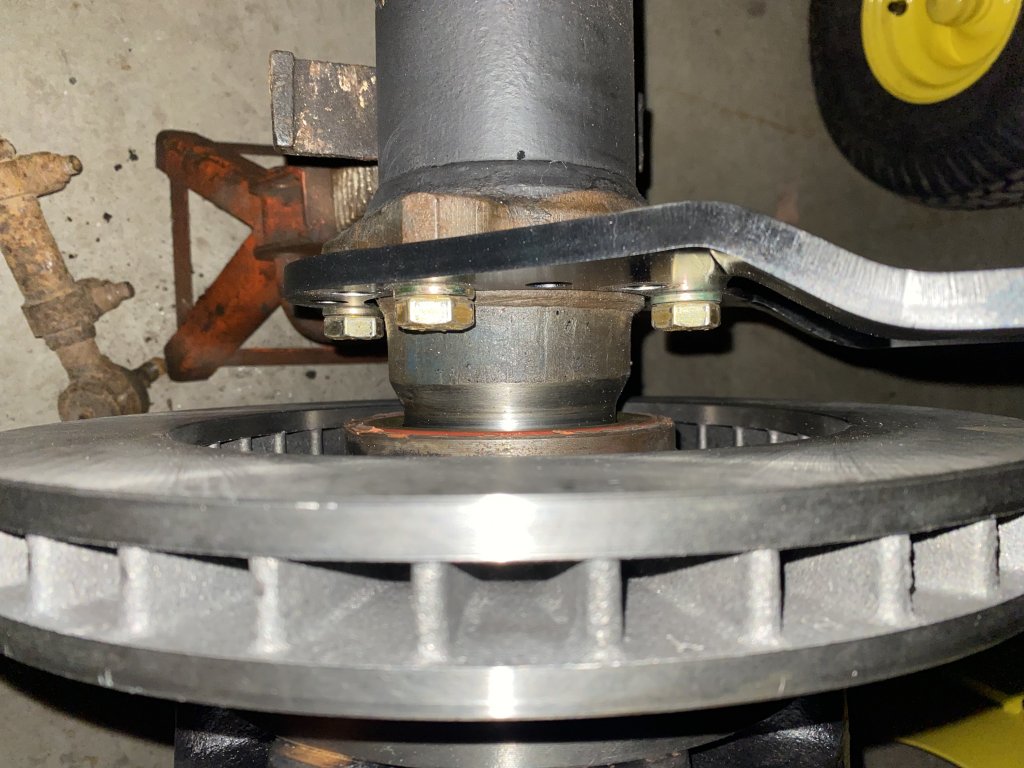

If you use split warshers there you will be sorry. Make certain to get the correct hardware for that job... I sourced parts from an aircraft repair place cuz it was tuff to find

Wrong application for split washers.
Without typing a book..they will loosen. And split. Not really much of a warsher at all. It is important to understand that the effectiveness of split lock washers is very low or nonexistent when used with heat treated fasteners of 8.8 (Grade 5) and higher. The spring rate of the washer is too low, and the edge of the washer will not dig into the hard fastener surface.

Split washers are really easy to find and ye old local faster supply place may not even be there anymore...depot dont got no flat warshers - go look for yourself if you must. :)
Airplane supply is a really good tip imo.
(worked for me - now it's all serviceable and stuff)
Reckon a split warsher would be one time use? If all that stuff is true anyways.. :shrug:

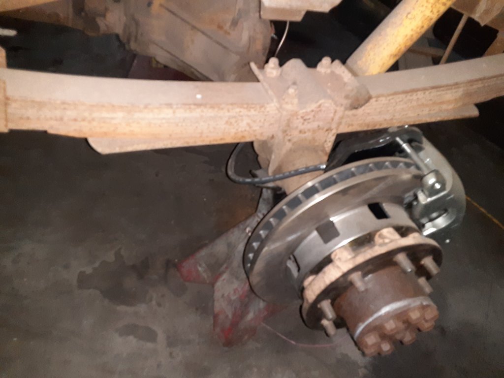

Looked through my 1977 C20s thread to page 14. Found some pix. Remember how unhappy I am with that...

This really boils down to crappy caliper brackets I reckon. You'd think there oughta be a better way to do this by now.
Not happy with mine at all obviously having to use warshers is the suck.
Whatever junk i used is not the right stuff either.

They do make special 3 bolt shims to space the caliper brackets. Mine came with welded on standoffs that were too tall and I had to take 1/8” off. Sounds pretty common to have to make adjustments.
Don’t forget the disc/disc Prop Valve (PV4 I think). Even with 35s, my K5 would lockup the rears prematurely with an Oh **** stop on dry pavement. Even worse in the rain.
