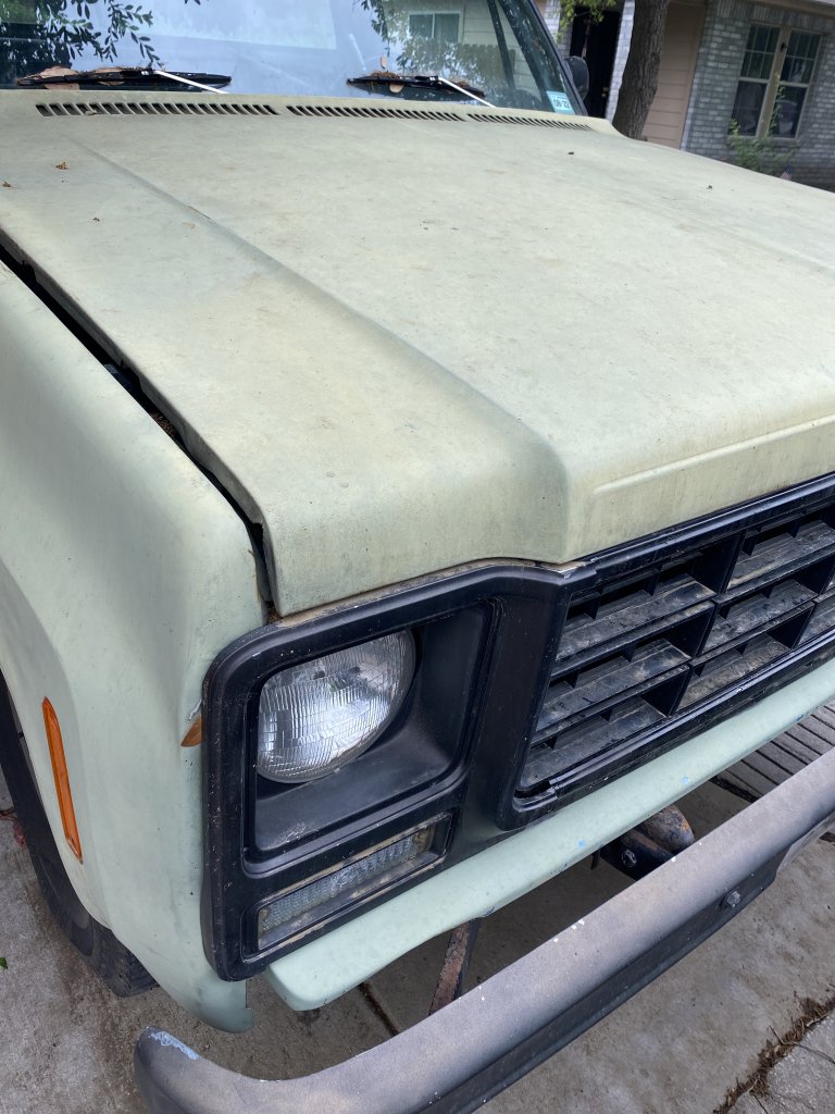

When I try to start it, it sound like my battery is dying. It cranks slowly but not enough to start it. With a jump it starts right up. Multimeter shows the battery to have 11.9 volts. Is there something wrong with my meter? The battery? The starter?

Sounds like the battery to me too. The best way to test this would be to load test the battery and check starter draw but since most people don't have that kind of equipment at home, try leaving the headlights on for 10 minutes and see if it'll crank and check voltage. A good battery should have no issues with 10 minutes of the lights being on. But ya, from just the 11.9 and jump start really sounds like a battery. You could check to see if there is a sticker on the battery indicating age as well.

Rule of thumb 4-5 years on a wet battery. There are exceptions but a dead 4–5-year-old battery, get a new one. 11.9 is very low.

Since you live in TX, I would go every 2-3 years for a battery. Heat kills them just like the cold.
BTW, after you replace the battery, check your terminal connections at the starter and on the alt bracket for cleanliness and tightness.

11.9V at rest, static measurement is only 30-40% charged. Well below the recommended discharge level of a FLA battery.
Your battery is dead bro! What you do not mention is trying to charge it. Are you insinuating it won't hold a charge after being charged, or have you not attempted to charge it? (charger or by driving the truck)

Is it that voltage after you start it too? You might have a failed alternator and that's why the battery is low. 11.9 volts is going to be 50% or less total energy left in the battery. I would start with charging the battery and test voltage while running. If you aren't seeing 13.4-14.7v while running, you have an alternator issue.

I agree 4 - 5 years as an average rule. But of course some live shorter and longer lives. On the other hand if your battery just so happens to be getting up there in years it would just be further confirmation that it should be replaced.
